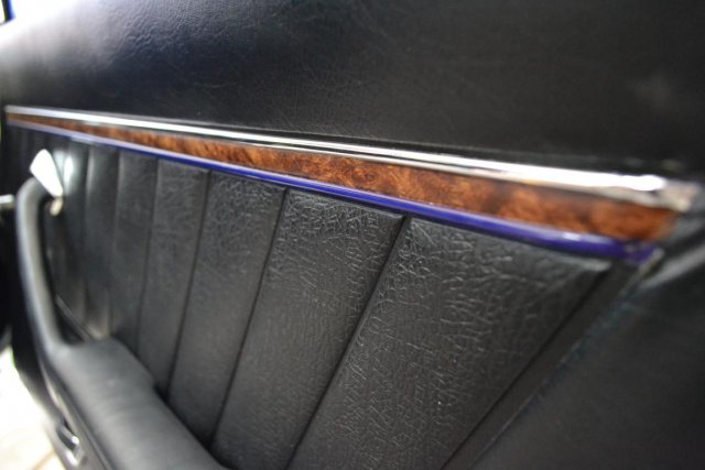

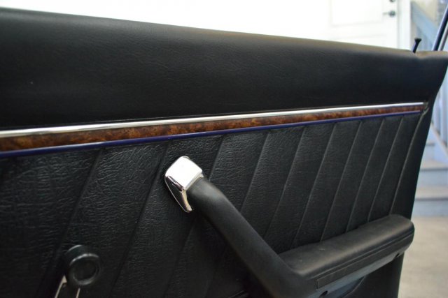

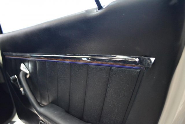

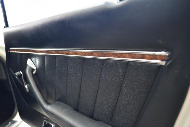

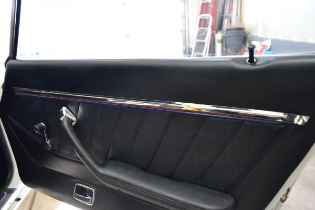

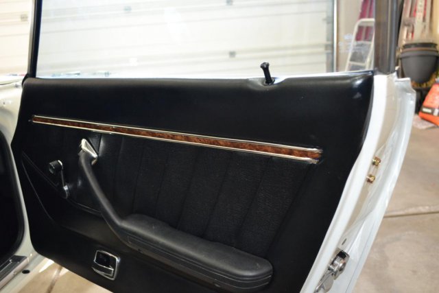

I "re-chromed" my door panel strips today. I bought some chrome vinyl wrap off Ebay and cut some strips and applied it with a heat gun. It turned out really nice. Heres what they looked like before, typical chrome peeled off exposing blue plastic. Much better....

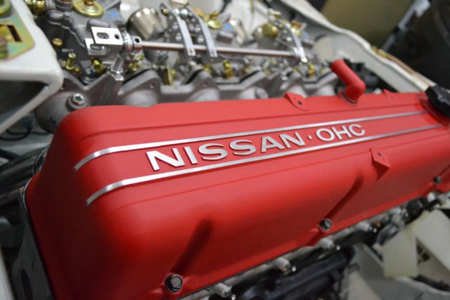

Got my valve cover on. Red powder coated and I sanded down the letters. I think it turned out good. Im not sure whats going on with my older pictures. I'll try and repost them.

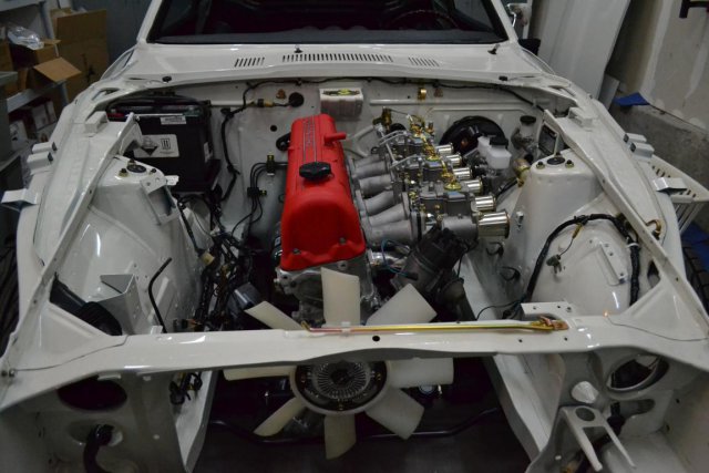

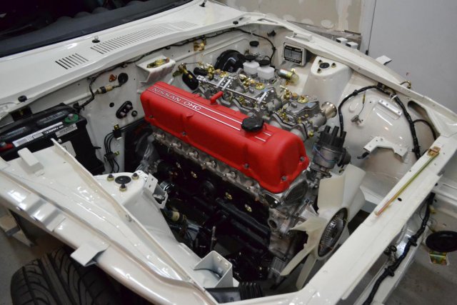

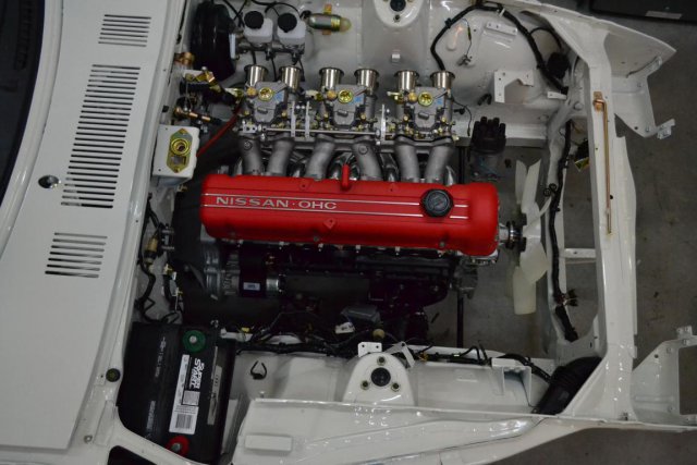

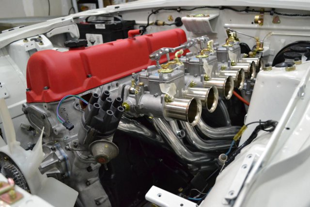

With the help of a couple friends and a few beers, I got the motor installed. Here's some pics. Headers and carbs dry fitted to see how they looked. I will need to trim a little off the intake manifold. I'll be replacing the valve cover soon, just need some new bolts.
Motor finally showed up. L28 with N42 head 3.0L Stroker 89mm Cast Pistons L24 rods with ARP bolts Turbo oil pump 63DI 109 Hot B Cam Triple 45 DCOE Weber Carbs Port & Polished head Port matched intake 11:1 compression Dyno Sheet:

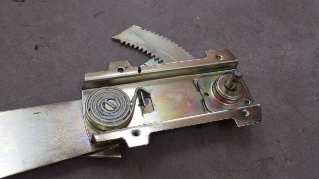

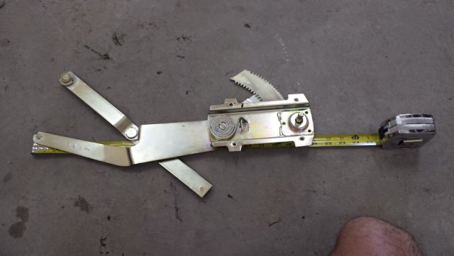

Looking for a window regulator for my 280Z. I think 74 or 75 will work. Here are pics for reference. Thanks!
