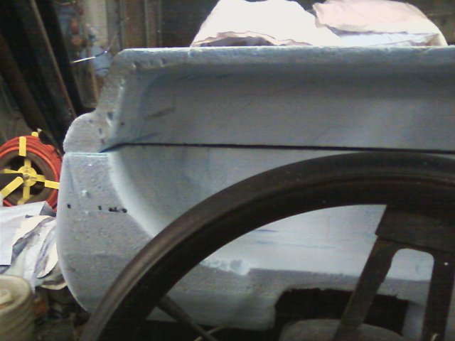

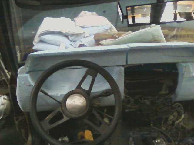

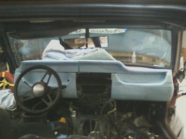

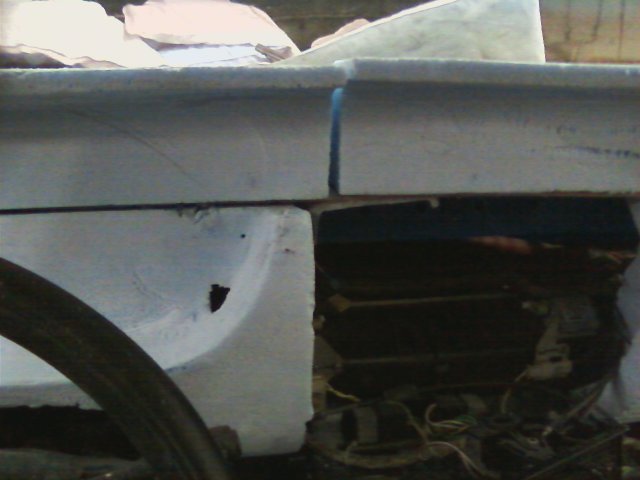

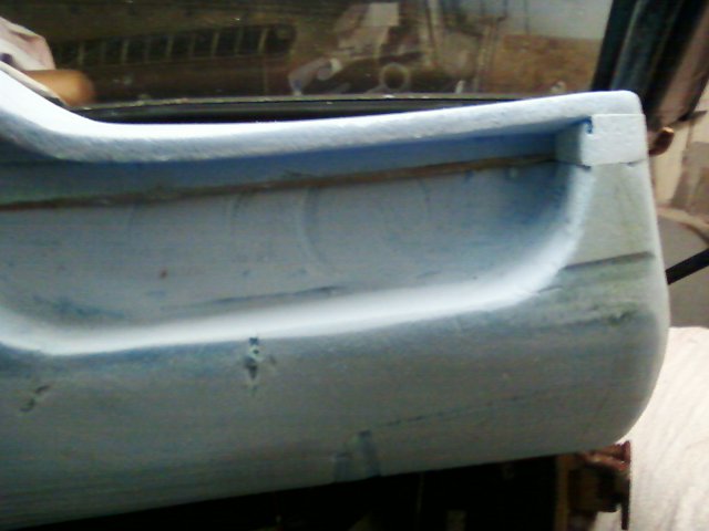

yeah i already sat in it and looked, at first i had it 2" higher to run gauges all the way across but lowered it and the top of the steering wheel from my point of view in the seat is at the same height as the dash. I think what you are seeing is the hump on the backside of it, i had to go back about 4" before tapering it off to allow room under it for the wiring and gauges. Got it covered in the 2nd coat of plaster to sand it out before painting it. I will take more pics after it is dry and sanded.
The foam was some we had left over from where i work, it was from a old sludge seperator we removed about 9 years ago, dont know where to find any more of it though the sheets were 4" thick and 2' x 6' long and i got 15 of them and about to run out from different fiberglass projects. I am going to have to start lookin around for some industrial foam because i still have a lot more fiberglass stuff i want to make.

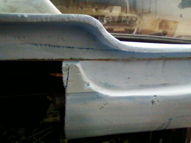

no, i just figured out how much room i needed for my gauges and switches and just started cutting it out, shaped the lower half with a home made hot rod then glued 4" foam on the and just went to carving with a grinder with a wire cup on it. Made some changes since then i covered the sutout onthe passenger side since i wont be able to see those guages over there. Got it covered in plaster right now trying to even things out and see how it looks. I thought about making a female mold out of plaster in case someone wanted one but... nawww

A few weeks ago i began forming the foam mold for my dashboard. I figured i needed to take some pics and share them. This is only the foam rough in. I plan to fill everything in with plaster to smooth everything out then paint it with several coats of enamel paint before i start laying on the glass. When i get it all done (3layers of glass) then i can melt out the foam with acetone and get rid of the remaining plaster with plain water. I still have to build the center section that goes down the front for the heater controls, radio and heat outlet. Bu that will be a seperate piece so i can remove it if needed. It was difficult to try and incorporate 9 2" gauges and the 5" tach and speedo into it all.

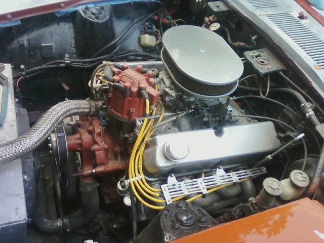

My 1988 lincoln motor uses a clockwise rotation pump with serpentine belt to run crank, water pump and alternator with no tensioner, just the curved brackets that i extended to make the belt tight, BTW if your alternator mounts con the passenger side just below the head you will have to find a serpentine belt mine ended up being 39"

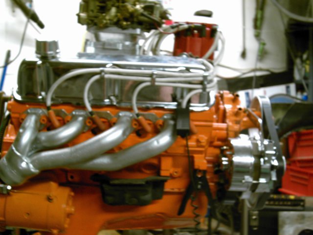

I built my 5.0 from a 88 lincoln towncar engine, heads milled .030, fully ported, port matched, polished, removed the smog bumps, used edelbrock torker high rise manifold with 2 1/2" spacer, Holley 650 cfm carb, E303 cam, timing gear set, balanced internals to within 3 grams, kept roller lifter setup, HEI ignition and took it to a friend of mine to put on engine dyno to break it in, first pass before and real tuning...351 HP, setting ignition curve and timing set....388 HP.. reset carb and jetting ended up with 438 HP. Dont let anyone tell you carbbed motors wont tune well, cant tune a EFI to get these numbers with out spend mucho dinero on injectors, throttle bodies and lots of puter reprogramming... besides when your efi screws up on the raod whatcha gonna do?? carb screws up you can make drivable in most cases.
