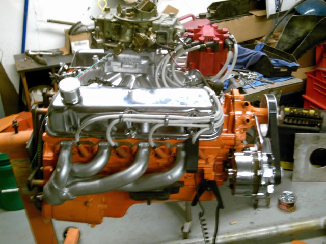

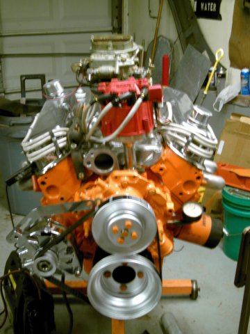

Well went to pepboys and fount they have a 39" belt but not the 38" version. Got it home and realized it measures 40" so i remounted the alternator and made it work, sure hope it dont interfere with anything hanging that low once i install the motor in the 500 Z
Ok, got my 500 Z engine ready and trying to install all the front end stuff but cant find the correct length belt to drive the waterpump and alternator. I need a 6 rib serpentine belt, 1" wide and 38 3/4" to 39 1/2" in length. Been searching all over the net and cant seem to find anything even close. Does anyone know a source, connection or even where to find 4 hole v belt pulleys for the crankshaft?? I will change to v belts if necesary. The crank pulley has to be the outer one of the 2 with a dish of 1 1/2" to 1 5/8" to the inside edge.

have bought 3 different sets of the shorty headers, seem to dump in the right place but wont know till install time. Biggest problem is they seem to be pointing to the firewall and the spread across the exhaust bores is different by about 1/4", got a torch and welder to fix that though but will find out later about the firewall problem. I still have the cast iron manifolds if anyone can use them.
