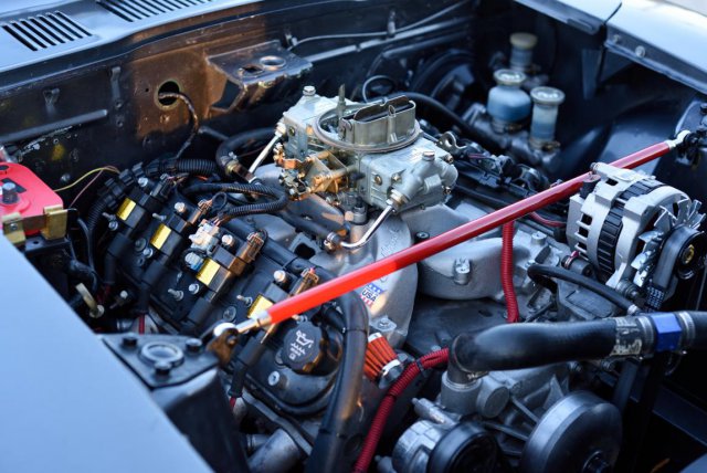

Heads GM 799s Port & polish $500.00 Block GM LQ4 New felpro head gaskets New felpro head gaskets $2,200.00 Intake Edelbrock 29087 Victor Jr LS1/ LS Carb spacer $300.00 Carb Holley 750 CFM double pumper stock $420.00 Ignition MSD 6LS Programmed accordingly $350.00 Fuel intro ¼ inch aluminum line paired with Carter Competition Series Electric Fuel Pump 100 gph Free Flow , 6-8 psi output Standby mr gasket electric inline pump installed $320.00 Valves/ retainers LS6 equavilent Stock $400.00 Cam The real question lays here. UPGRADE stock Gms Hot Cam install eventually Headers JTR 1-3/4" primary tubes, 3" collector $500.00 Exhaust 2.5 inch straight through to an 18 inch crossover muffler back to 2.5 to rear. custom $500.00 Trans 700R4 with transgo shift kit and B&M pro series ratchet shifter 2500 stall converter $1,200.00 Diff R200 with OBX lsd and hardened washers installed. Stock rebuilt axels $700.00 EXTERIOR Body Fully shaved bumpers. Sand blasted undercoated. painted New rubbers on all windows $7,200.00 Seats Nothing special. $0.00 Dash/ din steering wheel Z store cover ,full $220.00 Doors Panels and hardware mirrors etc. $400.00 Wheels Rota RBR 17x7.5, 17x9, bridgestone blizzak lm22, mickey tompson drag radials $1,800.00 Spoilers BRE front air dam, custom rear spoiler $320.00 Wiring Keep it clean wiring harness. 21 $300.00 Misc. All other randon things. Bolts, wires, connectors, fuel cell, roll cage, switches, tape, shrink wrap, fluids, radiator, fans, intake, loom, steering supplies, brakes, wheel spacers, etc etc. $3,200.00 this is about what mine cost. think it was close to 25K -
I didnt want the extra wiring and ecu for the EFI. later down the road ill be doing either the atomic EFI from msd, or an ITB setup. it still makes 412whp with the carb so im not too dissapointed with the power right now.
some random snaps i found. Thats about all the details I have on the build for now. ill post more pics when I find them.
