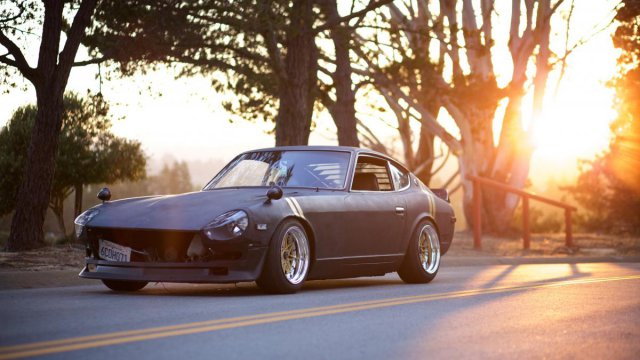

  6. Here's where I'm at with the wheels: got them mounted at some random tire shop on el camino- guy was super chill. Planned on rolling the fenders and seeing how close I could get to fitting them but even after cranking on 1 fender for a while I saw minimal results. I think I'll have to slit the inner fender skin and then I can actually roll/pull the outer lip- its not that far from fitting though. I'm ordering ZG flares with my first pay check so this is just a temporary fix.
  7. Went up to CSM and then down to hillsdale mall for some pictures. Here's my friends' Flickr: So, the official plan is install the Techno Toy Tuning arms/links ASAP And I'm starting to save for/piece together a plan for an sbc 350/sbf 302 swap. Not even my ideal motor choice.. but dirt cheap and even 200whp would be double stock out put so it should be fun- stay tuned folks!

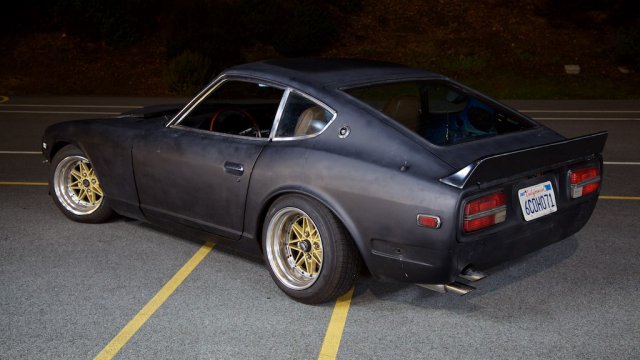

  9. Got the louvers, fender mirrors, and headlight covers mounted. For the louvers there is a strip of metal the hinges bolt to that slides under the window trim. Got them on without much difficulty, just took a while: This was the first iteration of the fender mirrors until my friend and I realized they might not have been facing the right way.. But they came out looking pretty nice Headlight covers were a PITA to get installed since I lost the mounting hardware in the move. Was anticipating removing the headlight buckets so the bumper came off and work
  10. Ya I've just been experimenting so I wanted to try both, although I don't mind it being asymmetrical. I added another stripe and some lettering on the passenger side. I think it evened it out and it looks a lot like an old fighter plane, which is the look I was going for. My friend taped the lights out with X's which I also think adds to the look. Final touch was another "HLS30" graphic on the ducktail- here's how it came out:
