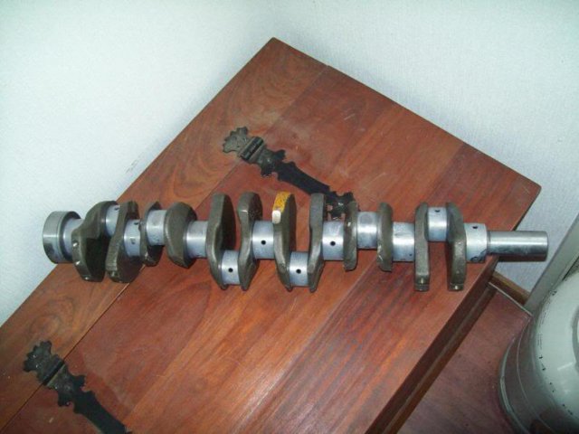

  4. For sale is one LD28 V07 stroker crank in great shape. Pulled from a running engine. Price is $1200 shipped to the USA
