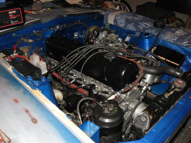

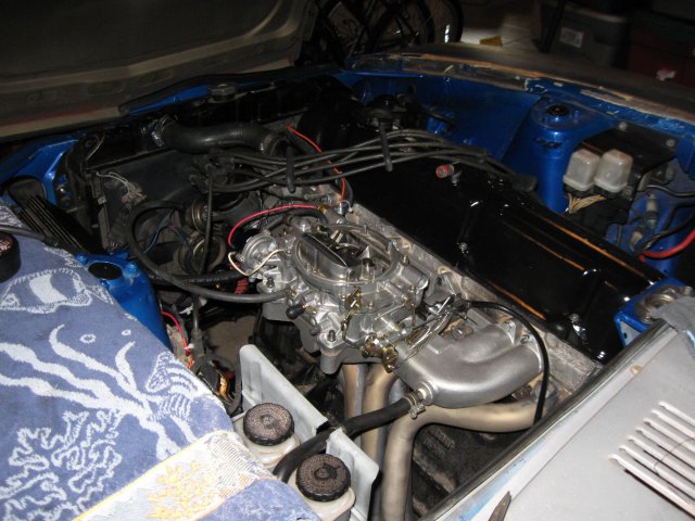

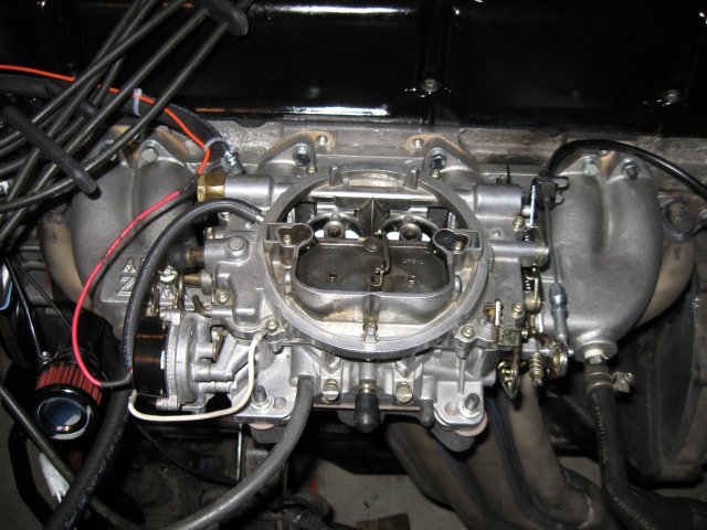

  14. Heres some pics of the finshed engine, a few random wires have been tied up before the drive. No more vacuum advance on the carb, ran to the intake now. Still a little flat in the power, but this is the first driveable tune, so im sure theres more on the table. -Thanks for the info citjet
