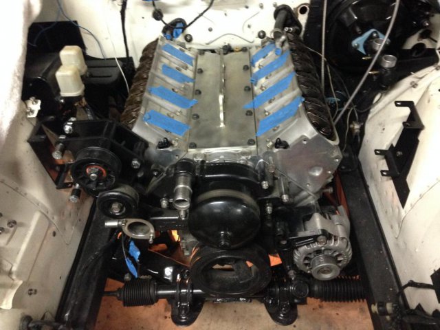

You can see the valley cover mod i did , cleans up the pcv lines.... I like the silicon heater hose i got. I filed the sharp edge off back of head the hoses go on but i decided to put on 2 90 elbows, so i can route better. I need to see if the stock fuel relay works ok with the walbro.... The wiring is the big issue right now, ill be nervous the first time i hook the power up.... And finding an air conditioner set up that fits.
I bought an old oven on craigslist and powder coated a lot of parts cheaply, but had the headers and y pipe out for ceramic. If u look at the tranny mount picture you will see how i had to use a few washers to get the angle good on the bracket. It ended up lining up ok but just barely. The hole i drilled on the drivers side is JUST above where the tunnel curve ends. I spent a whole day working on this, before i went for it. It is super solid though.....

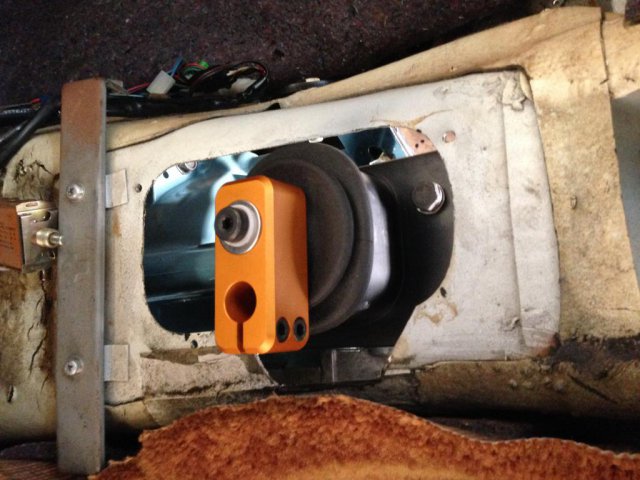

I used it on my 280, Motor mounts no problem. Tranny looks like perfect for 240 narrow tunnel but not ideal in a 280 cuz wider shape of the tunnel. Made it work I test fit the headers and they seem fine. Out being ceramic coated now. Hope this helps. Overall i like the kit cept for the tranny fitment. Really solid though. Trackzspeed used it too...240 Tadd -

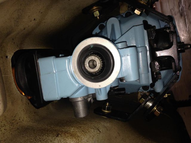

Put motor in for first time, made the cx racing tranny mount work for the 280 tunnel Not pretty but really solid.... Lined up the tranny spline with differential using a level laser, Test fit the headers they seem to fit well... Finally a little cooler weather... Here are some photos....
Put motor in, cx motor mounts worked great. The tranny mount another story.,, Bracket on pass side good but due to Different tunnel shspe of the 280 did not Line up very well on drivers side.,, Anyone else seen this isdue on 280?

Jim, thx for the pix very helpful. Looks like the tranny mount worked out well. Gettin close!!!! -
