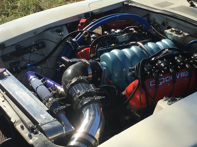

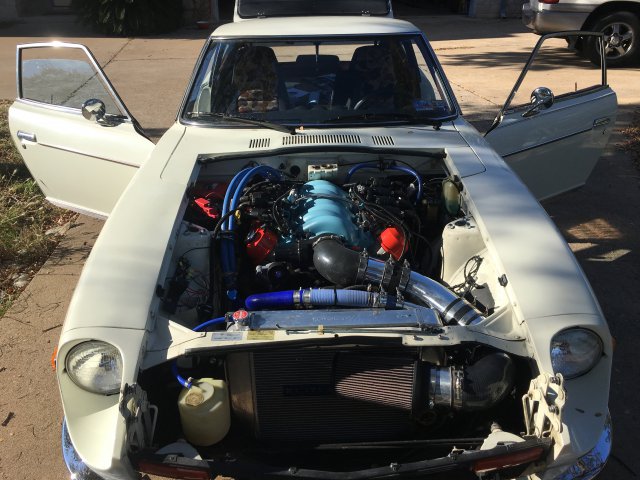

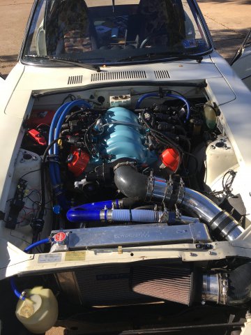

  6. replaced the ls1 with ls3 376 525 crate
  7. Alain where did you get your seats upholstered? My next deal... Btw I did the os giken w/ 3.91 Also the Mcleod Rst dual Both are working great.... These cars are stupid fast.... Your Z amazes me!!! Tadd in Austin
  8. 1978z original paint/interior LS3 525 T56 102mm throttle by wire 3.91 os giken L/S differential Techno toy suspension Techno wilwood big brakes front CX racing mounts, headers and pipes MGW shifter Borla muffler Frame rails Bumper conversion T56 tail mod for speedo All original guages Alignment by Soul Speed Tuned by Aikmam Performance Rota 16s Michelin pilots
