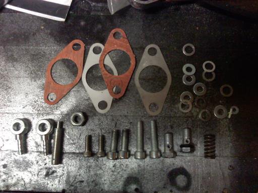

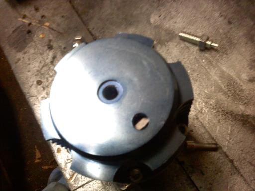

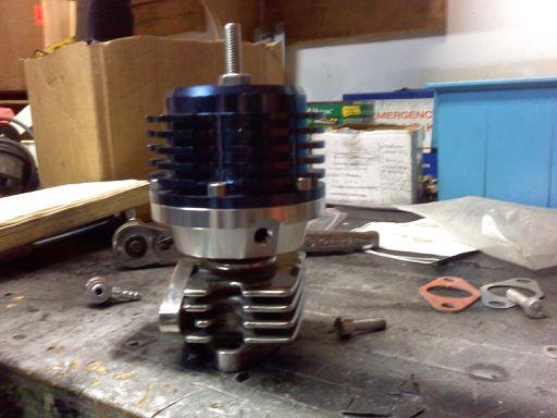

So I bought a 38mm wastegate from ebay that came with no instructions and a bag of random hardware. And well, I cant figure out how it all goes together and I really dont want to play around witha possible over boost situation. So maybe somebody on here has one of these? or at least someone with some more external wastegate experience could point me in the right direction as to how to set it up. It has 2 ports on the top and on the side and it came with the hardware in the picture. Thanks guys
