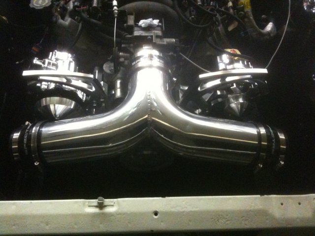

Here is a new cold air intake solution. We are working with Spectre Performance. This new set up is still in prototype, but here are some of pictures and what parts you can use if you are interested. Just mention Bare Speed to them. This will also be shown at the SEMA show this year. the pipe will come out of the 2 3.5 holes in the front near the L/R of the radiator. I will post more updates as parts come in. Part numbers: Spectre Performance 9741 2pcs 9771 1pc 97997 1pc 880100 2pcs these filters fit in the Y pipe. 9598 2pcs or 9599 7153 Great solution this saves so much space! MAF sensor that intergrates into the Y pipe. 9571 2pcs 9519 2pcs

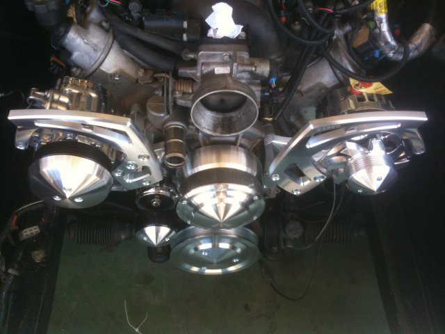

I think we are going to use a serpentine set up. How about some suggestions on where to put all the other parts dryer, and other parts. If have some pictures that would be great also. -

well after looking around somemore. I found other solutions. Serpentine kits. wow they are much more expensive but the look awsome. i cant see spending that much on pullies. http://www.jegs.com/i/March+Performance/655/20090/10002/-1 -

thanks Cable. I must have missed it. No I dont want to fab anything up. I was just wondering if there was another solution to out A/C issues. Ill see what he has to say. I know we are really over budget on this project already. -

how is everyone mounting the air condition using the JCI mounts? pictures or p/n would be a great help. thanks.
thanks for all the info. I think I am going to use the Summit version.

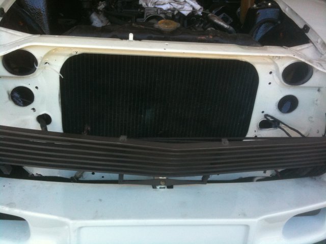

I have been looking for a radiator and found these that would work. Let me know your thoughts. http://www.koyoradracing.com/products/radiators.asp?make=Datsun direct fit and there is some N version where it adds some extra cooling. http://www.summitracing.com/parts/SUM-380325/ summit version and this would be a very tight fit. the frame rails are 25.5in across. this would require a hammer or some grinding. I would use the JTR bracktes or fab some up. http://www.jagsthatrun.com/Pages/Parts_DATZ_Radiator_Kit.html JTR set up looks nice also. all of these seem to be nice choices.

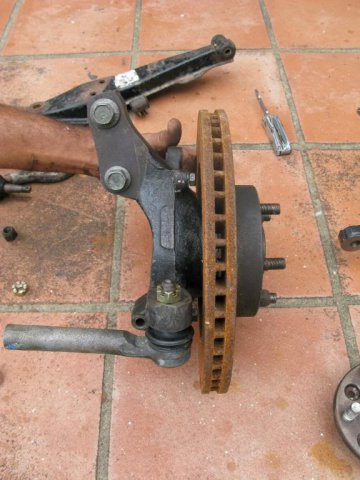

I like the idea. I have tons of coil overs sitting around. I thought about doing this at some point but dont have a the knuckles or donor car. Something to look in too. I do think it would take a few days to fab it up. Ill take a look around to see if I can find some parts. -

Any thoughts on the AZC set up? Its very costly but it comes with brakes. The set up is worth more than the car. It does look great. -

did the Conquest hubs work for you? I have had no luck getting a hold of Modern Motor spots at all. I need to find a hub that will work or use some custom made adapters. I found a company in So cal that can make them. they would be 35mm (1.4in) adapters. If using flares then there would no be too much of an issue. I would rather find another hub to replace with. -

doesnt Modern Motor Sports make this hub you are looking for? I was looking to do the samething. -
