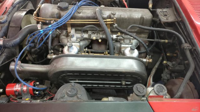

Got the FPR plumbed in and carbs were still gushing fuel. Decided to take the carbs apart and found that there were a few things wrong. took the carbs partially apart, cleaned and tweaked a few things, and got them back on. No more leaking. I also got a gauge hooked up to my FPR and found that I am only putting out just under 3psi of fuel pressure. I am thinking that since I have the low pressure pump wired into the stock location, that it's not getting the full 12v. All I can figure is that it might have something to do with my unplugging all the efi harness stuff and it just being zip tied in a bundle in the engine bay.
Well spent yesterday and today doing the EFI to SU carb conversion. Unfortunately the K&N electric fuel pump puts out a good bit more fuel pressure than the little SUs can handle. Got a Holly FPR on the way.

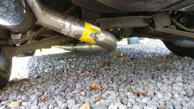

It was a pain but built a 3in mandrel bend exhaust for it. Stock down pipe but from there I have a 2ft glass pack then to more 3in pipe the to a muffler with dual 2.5in exits. I'll post a few pictures tomorrow. I also swapped the hatches from the parts car. The green hatch is damn near mint so no more leaks!!! I almost hate to put holes in it to put a wing on it

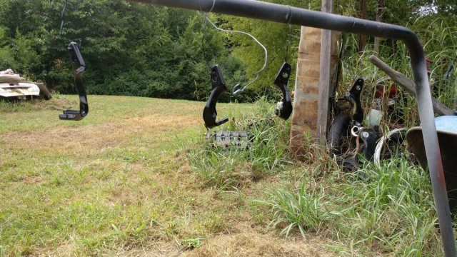

Well it's been a while since I have had anything post worthy. Last weekend I got the exhaust manifold back on and was going to build the new exhaust but my friends welder was out of gas. I spent a little time yesterday tinkering but it was gross out so I didn't accomplish much. I did however sand blast and paint some S13 Ebrake caliper brackets for the rear disc brake mod I will be doing. I am going to have the prettiest rear Ebrake brackets for sure

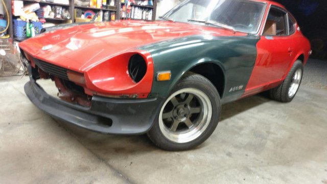

Got the fenders lined up and bolted in. Also got the front airdam mounted. All I have to do is figure out some brackets and I can get the 240Z bumper mounted and the front end is basically finished. As soon as I get the exhaust manifold from the machine shop I'll bolt it back and build the exhaust and I'll be able to drive it!!!
cool. do you think the tack welds are strong enough to handle the force of the ebrake cable?
