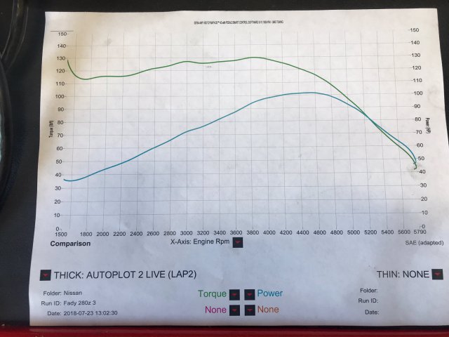

    L28 on MS2 low power
    Hey guys, Got my tune done on my 76' L28 280z last week and the numbers are a little lower than I expected. Hoping you guys could help. Attached are my tune, log file, and dyno printout. Also, when the car gets hot (i live in Phoenix AZ) i love RPM signal and the car stutters Stock header Cold air intake W45 Intake manifold N47 head AEM Wideband MS2 235cc injectors 3 2.msl fady miata Dyno final.msq
    With the exception of the intake and the megasquirt, the engine is in stock form. Even with no mods it seem a little low on power. I was hoping someone would see something I was missing in the tune before I got down the rabbit hole of modifying the engine.
