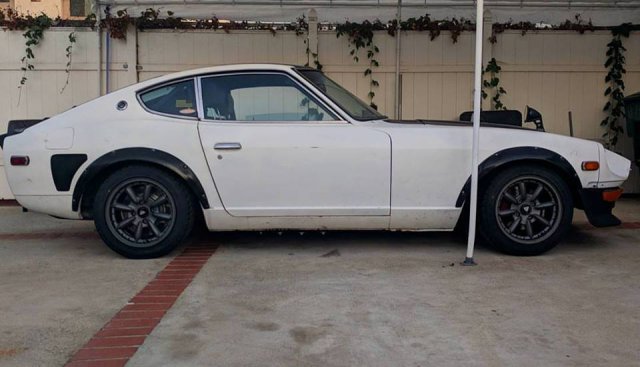

Car is a 1973 240z with an L26 basket case, with lots of rust and wiring issues. Since my initial question thread started getting offtopic, I figured I would finally start a build thread to expand on my questions, and document my progress so far with the car. Original thread is found HERE Parts are on order and I'm slowly putting together my EFI / ITB setup. I'll post updates and questions here. Since the start of that thread, I've really dug into the car to find terrible rust as expected. So, first order of business was replacing the floors and flame rails. Got floors from zedfindings and rails from baddog. Passenger side before paint. Driver side painted. You can see the rats nest of wiring hanging under the dash. Going to have to clean this all up pretty soon. My car didn't have seatbelts when I bought it, so I also put in a half cage and harnesses. Cage was built and welded in by a local shop. My seats currently sit too high for my liking (and for the harnesses), so I'm either going to get new seats or a build a smaller seat bracket. Also replaced redid the entire braking system with 4 piston discs in the front, converted the rear to disks, and a new master cylinder. I've also replaced most of the suspension bushings, still have a few to do. This weekend I am going to pull the head off to get it rebuilt. Which leads me to my first set of questions. I thought the car just had a stock L26 in it. But now I'm not too sure so I need some help identifying stuff and how to move forward. The block is stamped "L26 086142" and the head is stamped "N42". I previously did a valve adjustment, and I remember checking the cam markings and it had standard mark but now that I realize it has a N42, I'm not sure if it hasn't been reground. There is a isky racing cams sticker on the car window, but who knows if that is just for "show". When I pull the head off, how do I go about identifying the cam? And if it has been reground? How do I check if the head has been shaved? What should I look for inside the motor (should I expect flat top pistons? Or dished? or notched?)? Given that I am going megasquirt EFI with ITBs, what should I have done for the head performance wise? Valve springs? Cam suggestions?

Bumping an old thread with updates and seeking more advice as always. I guess this thread is going to devolve into a general build thread? The megasquirt/ITB plan was put on hold for other things done to the car in the meantime. But finally getting around to getting the parts together. Done : 1) upgraded the braking system : 4 piston fronts, and disks to the rear from silverminemotors 2) new floors from zed and new frame rails from baddog 3) added half cage and safety harnesses 4) new wheels and tires 5) all suspension bushings done In progress : 1) Rewiring the entire car. A previous owner did a terrible job of installing a rats nest of a "painless" wiring harness. 2) New radiator and fans To Do in the next couple months: 1) rebuild head 2) get megasquirt/EFI working So here are some questions for you guys. Regarding the head I believe its an E88 that came with the L26, but I'll check tomorrow morning and make sure. 1) If I am going EFI and ITBs what cam do you recommend? 2) Rebuilding the head, I'll be taking it to a machine shop, but what do I need to buy for them to complete the work? 3) What are my options performance wise? Shave the head down to increase CR? how much? Keep in mind, I live in CA so I only have access to 91 octane. Regarding ITBs/Megasquirt Going with MS3X with the expansion. Using the two harnesses from DIYautotune to make my life a little easier. Got 2 sets of triumph ITBs Off a 2012 675 Daytona, talking to the guys at DIYautotune and I should be able to reuse the TPS and ISCV from triumph. Going to use the lambda controller Derek recommended. 1) For Crank position and Cam position I was going to switch to the distributor from the 1982-1983 L28ET and use this trigger wheel. Will this distributor work with my 240z's tach? If so, how does it get wired in. 2) What size fuel pump and injectors will I need? I imagine I don't need anything too crazy right? 36lb/hr injectors? Pics of the car as it currently sits in it's dirty state.
