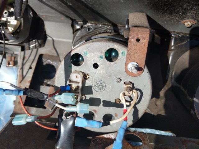

While posting this I also emailed technoversions with my questions. He's currently looking into the MS manual about the tach signal output, but he believes that the tachoutput signal from MS should be enough to trigger his adapter. If that is the case, it can be wired up similarly to his diagrams. I'll report back once he gets back to me. I'll make sure to document all of this after I get it working in-case someone has similar questions in the future.
So I've been doing some reading on this, and I want to make sure I got my ducks in a row before I spend money on an adapter. Car is a 1973 240z, being converted to MS3x 3.57. Factory wiring is gone, no coil etc. Here is a pic of my tach, which if I understand correctly is the current sensing type. I've been reading this thread about using a MSD 8920 adaptor. And here is the manual provided by MSD So from my understanding there are 4 wires on the MSD box. 1) Ground 2) Tach signal input 3) output to tach 4) violet (unused) I connect the MS tach signal to wire #2. I take wire #3 and connect it to one end of the tach loop. I connect the other end of the tach loop to a +12v power when the car is running or starting. And I ground wire #1. Will this work? The other option is using a TM-02-I from technoversions. The instruction manual can be found here. 1) One end of tach "loop" connected to +12V when running or starting 2) Other end of tach loop connected to pin 3 on the tach adaptor (with or without power resistor?) 3) Pin 1 connected to +12V when running or starting 4) Pin 2 connected to ground 5) Pin 5 connected to megasquirt tach output? Also, on the technoversions adaptor manual, what is the difference between the two +12v sources?

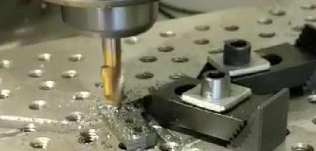

I've been traveling for work the past few weeks so I haven't been able to get much done. But this weekend has been pretty productive. Got the distributor swapped over to the turbo distributor to give me crank angle and cam position. Got the AC compressor mounted as well. I had to CAD up and mill out a little bracket to adapt the throttle linkage to the factory triumph cable pull. Here is the completed linkage and a crappy vertical video -

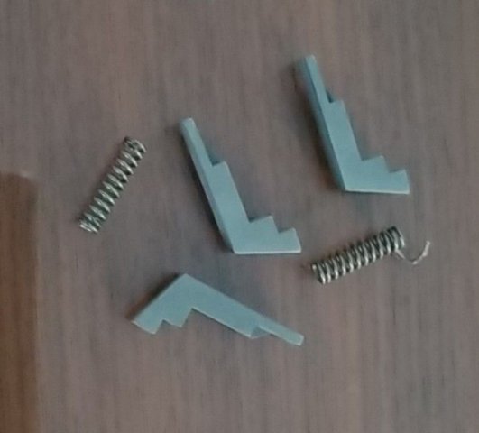

I'm going to be plugging my old feed, return, and vent holes off the tank and using the stuff from the new pump mount. What are my options for plugging the openings? Are there any fuel safe rubber caps? Or do I have to go with the bolt clamped into a fuel hose method? My datsun's mysterious history continues to baffle me. Started working on installing the fuel pump in the tank today. Cut open the top, cleaned it up etc. Found these guys rattling around inside the tank. No clue where they came from. Any ideas guys? -
