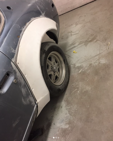

Anyways, back to working on the rears! This is just about where we wanted them, so we riveted them in place and started to bond them to the car. I was SOOO happy with them at this point! However, my plans were to have them molded onto the car so I knew it wouldn't stay looking like this. I was a little scared of having them molded because lots of people expressed their doubts and warnings about having them molded! BUT, I have faith in my body guy!!- 35 replies

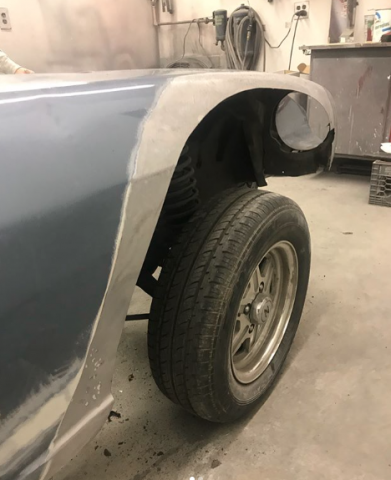

I wish I had a couple pictures to describe this next problem we ran into, but I don't! So I'll have to do my best to try and explain it. SO, yes we cut the original fenders back, NO you could not see them underneath the mafia flares anymore, HOWEVER, the flares were hollow! So the flares were only going to be bonded to the upper metal of the car, leaving the underneath completely uncovered and ugly looking! Thankfully, my body guy is quite a body guy and found a way to make the most beautiful custom under fenders! THEY CAME OUT SO WELL! I'll try and get you guys some pictures so you have a better idea what I'm talking about!- 35 replies

Next, we fit the fenders on the car and riveted them in place. The backs went on pretty easy, mostly all the lines in the fenders went with the body lines of the car.- 35 replies

The first step once my car got to the body shop was to bring down and cut back my original fenders. You could see them underneath the Mafia flares, like a lot! I couldn't imagine not cutting the fenders back because as soon as you were to see the car from a low angle, there were the old fenders underneath! It was horrendous. Here is a picture of how high we had to cut the fronts back. I don't have a picture of the backs cut, but trust me, they're cut!!- 35 replies
