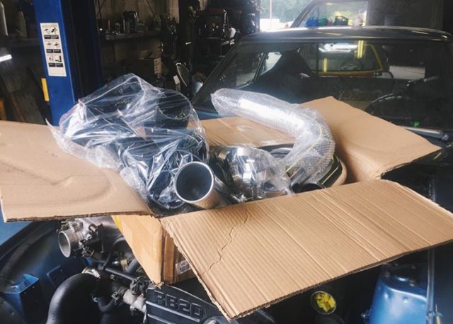

  7. After the exhaust was finished it was a lot of days of NOT touching the car. Ten days of vacation, some beach days, but all days were days I was thinking about what would come next to Dirty D... By the time I got back, all of my intercooler piping was in. However, we also just ordered a dyno for our shop and fortunately that came in as well! So for the next couple days we had the floor cut, dug the hole ourselves and had that little guy put in! Coincidentally it was also the same week we decided to plasti-dip the 818C at the shop so we did the hell out of that as well! And it is surprising how easy that stuff sprays on. The plasti-dip is gonna stay on until next year or so when we send it out to get the body work done perfectly and painted a mclaren orange type color! Until then, that bitch is looking good!

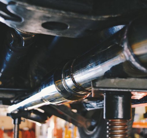

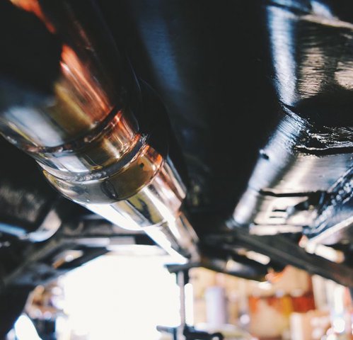

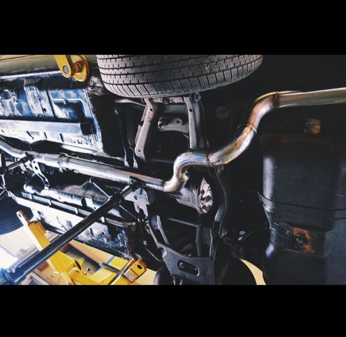

  8. Hey all, I'm back again for another update from where we left off! Okay, so we left off with the engine dropping in and getting fitted. After that, I surely thought the car would be up and running within a couple days. LOL. Can confirm, was not the case. The next thing we did was start mocking up an exhaust. I ended up buying a downpipe, a 3" resonator as well as lots of 3" stainless steel exhaust piping. We ended up using some pieces I bought as well as some exhaust pipe laying around the shop. It took a couple days of test fitting and tig welding to finally get the exhaust just how we wanted. We decided it would be best to weld and fit the exhaust into one long piece of pipe and then attach that to hangers instead of welding piece by piece to the car. But I think it came out looking amazing! I absolutely was dying to hear how it sounded. We mocked it up, got it in place, made some custom hangers and got it in for good! Those pictures were taken just before we made hangers.
