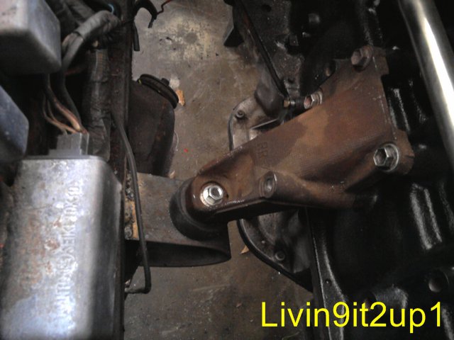

Every word what you said made perfect sense to me, i love the way your mounts came out, i have reconsidered my mounts and have defiantly decided to reinforce them quite a bit, I am not worried about twisting the frame due to the fact that my original cross member is only 8 or less inches away, I am trying to decide what approach I am going to take to reinforcing them. I made sure to get the "#2. Now with a straight through bolt(single), with rubber in the middle surrounding bolt" mounts due to the fact of iv seen many of the glued type rip apart from hard launching and that just seems id be asking for mount failure trying to use mounts like that.

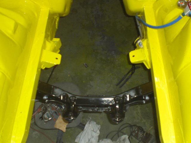

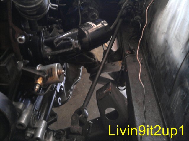

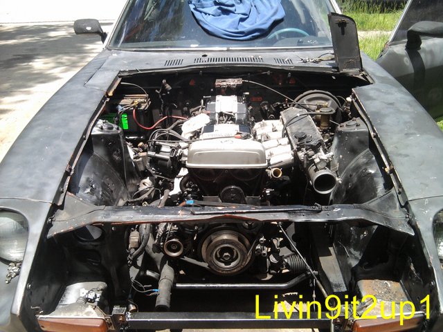

As to my method of aligning everything i just hung the engine in the bay and fine tuned the angle and alignment with jacks until i got it right. I measured from the bolt for the crank pulley to the rails to get it centered in the engine bay. At first i was going to go with the beta Motorsports kit but i decided against it due to the cost of it. So i went with the idea of fabbing up my own mounts. i had 2 options, first being make a cross member and building mounts off of that, second being coming right off the frame rail in the engine bay. For the sheer cost of things and simplicity i went with coming off the Frame Rails. I can only find picture of them before i boxed them in, but the show the gist of how i made them. By the way i made them out of 11 gauge cold rolled steel. I went down to my local Napa and went through there catalogs till i could find a rubber mount that fit my needs, needs being as skinny as possible to save room. They Rubber mount is literally 2 millimeters away from the steering shaft. I didnt use the Beta motorsports kit

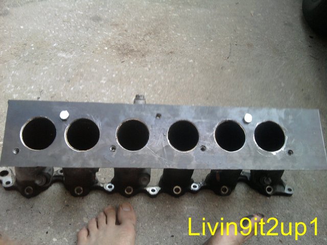

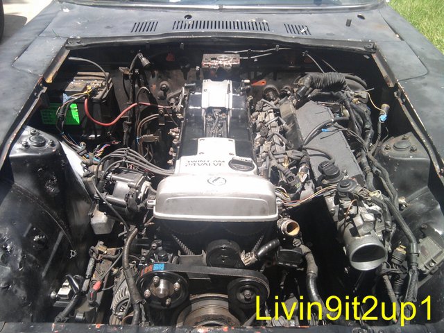

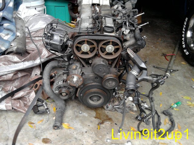

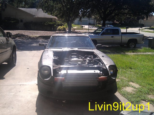

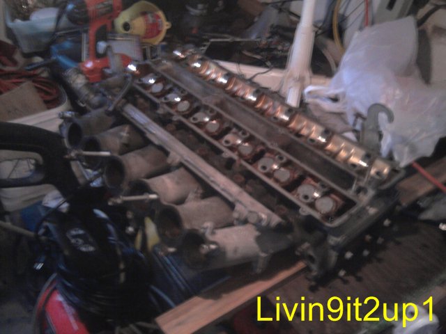

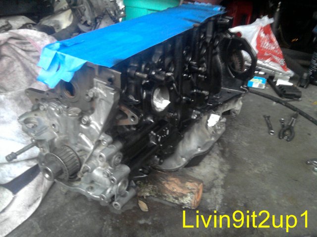

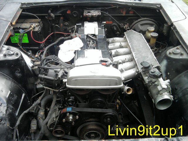

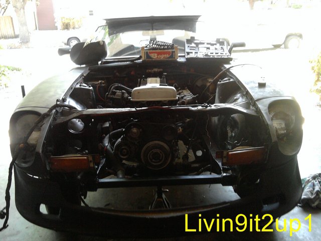

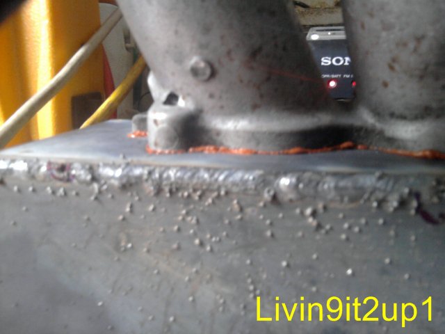

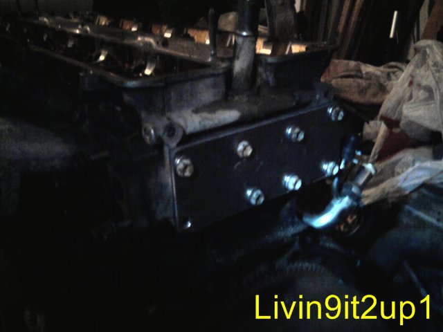

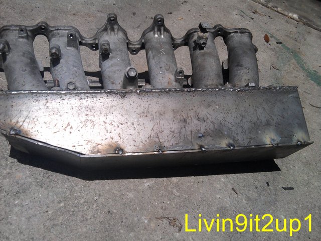

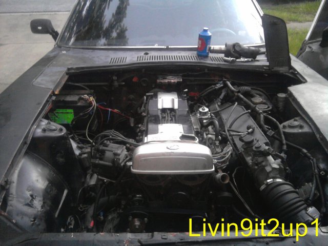

This project stared back in march after i melted Cyl 4 in my l28et from a clogged injector. after talking to a friend who owns a shop for a couple of hours i came to the conclusion that i was gonna do a 2jzge from an sc300 built up, i was eventually going to Na-t it. I'm not looking for big numbers probably around 350 400 HP. I have been taking pictures the Entire way but haven't had the time or patiences to post them up on here. please dont make fun of my stuff, i know some of it probably doesn't look good but i spent a lot of time getting it all right. Thankyou guys for the positive comments but please keep the negative ones to yourself. (unless its something that i overlooked that could probably help me) The day i got the motor Head removed for cleaning and Complete check Block Painted and halfway assembled EGR Block off plate Mounted in the car, i know its a little crooked there is not a tranny mount at this point. Custom intake manifold Wiring fun love that intercooler too bad i had to trade if for a new ecu wiring complete

I got it working finally! I just used the stock 280z alternator plug and wired the 2 wires from that directly to the alternator plug, and the last wire, i believe black and yellow runs into on of the plugs by the ECU and i wired that to switched ignition power. Started er up and ran 14.15 volts right off the bat. Thanks for the help everyone!

Iv done it! iv successfully swapped a 2jzge from a 93 sc300 into my 280z, i have it running perfectly with the factory 2jz engine harness and computer, now the issue.. i cannot for the life of me figure out the wiring for the alternater. any help that can be given would be really appreciated, thank you in advanced!
