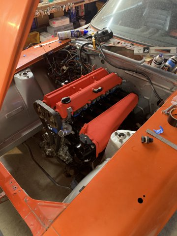

Hey man, I apologize I haven't really been on here lately. I ended up having someone remove the bends, add crush sleeves to the rails, and weld the bolts to the rails as well. I'd like to mention though that I only had these problems because I did not weld the crossmember in. If its welded, you won't have the issues I had. I just wanted the option to be able to easily remove the crossmember. You can follow my build on IG if you want: jz_s30 (Ignore the overspray that will be taken care of at a later date)

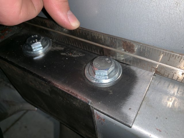

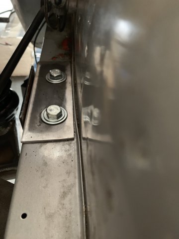

This is the beta motorsports mount. Originally I bolted it in just to hold it in place and to test fit the motor so I could see if it was in the correct place. I was planning on welding everything up afterward but then this happened
Do you think I could just pull this slight crush out and install the crush sleeves? Or is this a bigger problem?
It’s a 1973 240z. I can see the spot welds, I don’t remember exactly how close together they are.
Hey guys! I finally test fitted my 2JZ in my car. I had a custom made crossmember made (I can’t remember the name) and I only ran into one problem. It looks like the frame rails slightly sunk when I tightened the crossmember in place (maybe I tightened it too much?). Should I worry about this? Dropping the engine in did not make it any worse, and I’m planning on welding everything up.

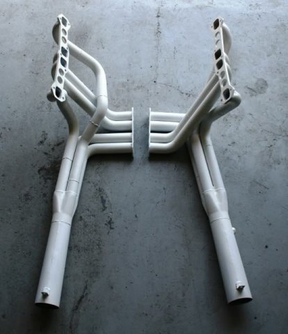

Has anyone tried to install 180 degree headers?

Thanks for the tips! I’m definitely going to put the flange in between. I don’t see how it would ever come off otherwise lol. I’m going to do a ton of research, in your experience, how much do custom headers usually cost? -

I'm asking if you guys think I should be okay running it as is or if it will cause issues
