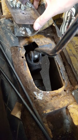

    Awesome, I do plan on welding them solid once I have everything where it needs to be, so I don't think that'll be an issue for me either. I honestly feel like the factory sub-frame would be more of a weak point. I do plan on using class 12.9 hardware for everything, so hardware strength shouldn't be an issue. I plan on running stock turbos so hopefully they're small enough to not interfere with too much. If I have to, I'll shorten the driver's side engine mount or lengthen the passenger one to ensure there is enough space for everything and even offset them forward for the shifter placement if I need to. I have a shifter relocation kit to move the shifter very far forward, so it should be pretty close to where it needs to be. The early 240z cars had the trans tunnel hole for the shifter and everything about 2" further towards the rear of the car so that helps me. (reference:http://www.zhome.com/ZCMnL/tech/AandBtranny.htm) My car definitely has the more rearward hole cutout because when I bought it, it had the "B" style transmission and the tunnel was mangled in front of the shifter from whoever did the swap. I plan on taking it to a track to race my brother, but I'm not going to be racing in the SCCA or anything, it's more of a fun car, and if I end up seriously getting into racing I'll have to upgrade the cage, seats, and harnesses anyway.
