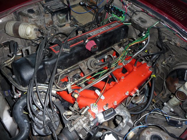

I've been a member on here for a couple of years now and have since owned two z's. The first one I bought back in '07, its a '75 2+2. I swapped in a '82 l28et and drove it around for a year or so. the body on the 2+2 is pretty rotten so i started looking around for a good roller that i could swap my stuff into. While looking around i started updating the drivetrain; -MS 1 v2.2 running an HEI 4 module. -larger water-cooled turbo -walbro 255 pump -AEM wideband I got the car to run on MSnS about a month ago, and then i found the perfect donor car. Its a '77 280z that is extremely straight and only has rust in two areas, the pass frame rail and battery tray. Working on the car tends to be a slow project, i only have time on some weekends and on breaks. I'm currently finishing up my last year at Purdue University studying mechanical engineering. And on my summers i have been working for Ford in dearborn so there is no way to work on my cars then either. Im hoping to finish, or at least get the 77 driving this winter break. As for some of my custom touches i am currently finishing the back roll pan that the previous owner started. I also finished my center console and started going through the suspension and prepping the engine bay for the turbo motor. Here is a switch panel i made that will go under a new pioneer radio. let me know what you guys think, it was made from a sheet of aluminum and some hand tools. my plans after this week, since finals will be over, is to button up the suspension and body work. Paint the engine bay and run all the wiring for the megasquirt. Then patch the frame rail and battery tray. Then install the interior and engine then hopefully load up my base tune and drive it around a bit. Ill try and keep this thread updated with pics if you guys want!

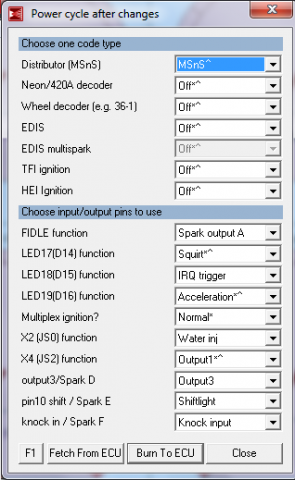

LETITSNOW you are now my hero!! thanks so much, i switched those two settings and she fired right up. idles smooth and afr's thus far seem good. HYBRIDZ you guys helped me so much through this build. thanks!!!!

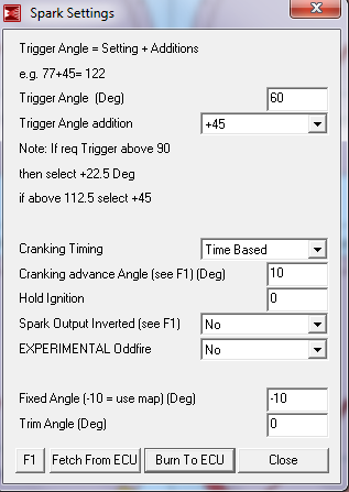

It has that. I am getting enough spark and fuel for the car to stutter but it wont hold an idle. I am thinking its possibly the timing. I cant get the middle LED to light up when i tun the crank to 60 BTDC and im thinking it could have something to do with my settings. Here is a screen shot maybe it can help.

So i have been working on my car here and there for about a year now but can't seem to figure out how to get it to idle. Whenever i try to set the timing the middle LED never lights up, I can get the car to spit and sputter but never hold an idle. I dont believe the injectors are firing and my timing is probably off still. I am in over my head and since i'm back in school and winter is coming soon i need to get this car running, since my other car can't be driven in winter. Im hoping someone in the indiana area could give me some pointers, and at this point i'm willing to answer any questions and pay (within a reasonable amount) to anyone that can help me get the car started so i can begin tuning. If you guys have questions about my settings i can upload screen shots of megatune. Oh im running a MS1 v2.2 with an HEI module and wired as per Mobys writeup and stock 280zx-t injectors with a 75 resistor pack. Thanks for any help you guys can give. Kevin
