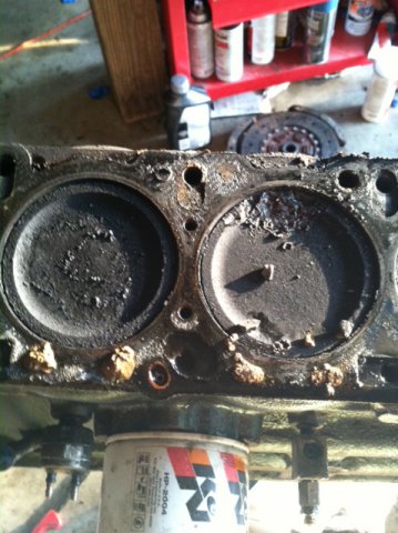

Im seeking advise on what my options are regarding my car. So I have a '77 280 that I initially swapped a '82 l28et and MSnS into it but I blew a head gasket and when I tried to get the motor apart all the bolts on the front cover and oil pump broke and were seized, so there was not any easy way for me to take the motor apart and fix it. I found a '83 l28et for sale on here from username "monster reem" and we agreed on a price of $650 for just the motor. It was advertised as a perfect working condition motor pulled from a running car. This being the main reason I purchased it since I hadnt the time to rebuild mine. Over the summer I worked as an intern at Ford Motor Company which made it impossible to work on my car. So I bought the motor and took it home then headed back to Michigan. At the conclusion of my internship I was able to pull my motor and drop in the new one in one day but upon starting the engine it had a severe knock. I emailed "monster reem" and told him about it the fact that this motor had to be hurt before I purchased it. I asked him if it was possible to get my money back but he refused claiming it was sold as is and I must have hurt the motor and am just trying to get my money back. Here are some pictures of the motor after I took it back out and took it apart to try and see how bad the damage is. So i guess my main question now is where (if anywhere) can I go from here. I'm finishing up school and getting my degree in mechanical engineering this December and also getting married in April so money is extremely tight. The head is destroyed I'm assuming and I know piston 3 is done as well. I'm hoping there will be a decent way to get some of my money back so I don't have to part out my car to get money until i graduate and get a job. Thanks guys.

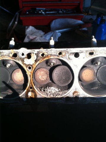

Made the trip home over the weekend and was able to get the car to start and run. So I warmed it up and then performed a compression test, with the following results. Cyl # ; Compression 1 : 40 2 : 98 3 : 104 4 : 107 5 : 103 6 : 101 So i went ahead and ordered a head gasket but I won't be able to work on the car until July. Thanks for your guys help and suggestions

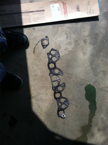

Here is a picture of the gasket that came off the car. This had me pretty confident that the problem would be solved by the new gasket but it wasn't.
That was my first thought as well, My brother took the exhaust manifold off yesterday and replaced the gasket and that video was shot after the new gasket was installed. I know the manifold is cast iron how brittle are they. Is is possible the manifold is cracked. Once again I havent had a chance to personally look at the car being in Michigan for the summer.

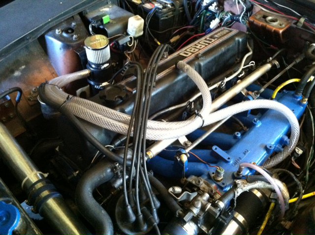

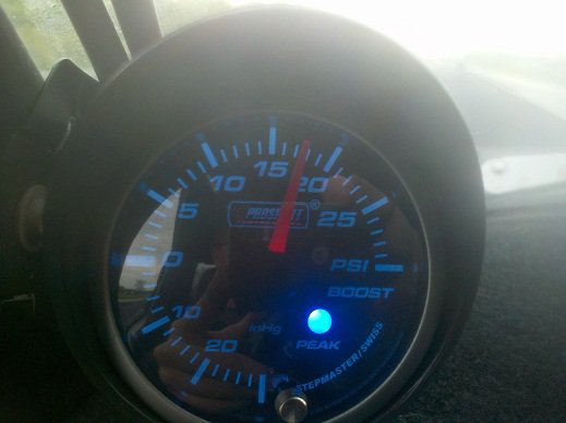

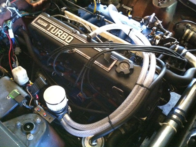

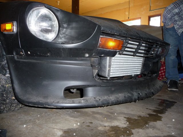

Here are some pictures of the car in its present state. Its running 15 #'s right now but I did try 18 to see how it felt. But i'm hoping to get it dyno'd soon to see what power it has. Then i will start working on my cobra since turbos are on my mind it will be getting a built teksid along with a single turbo.
