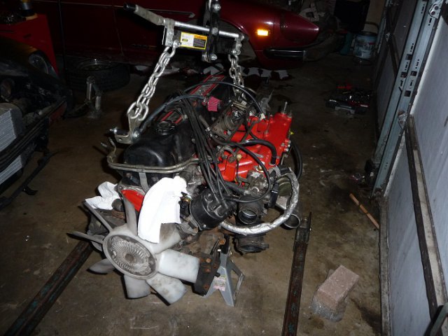

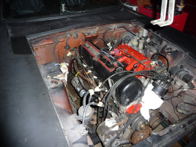

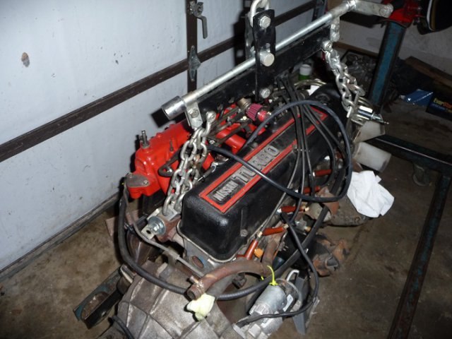

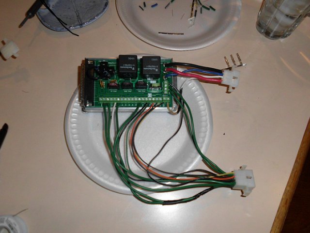

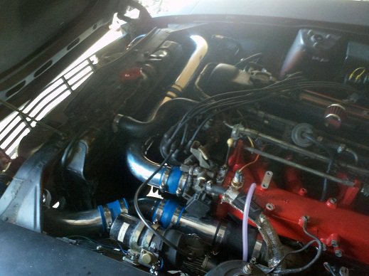

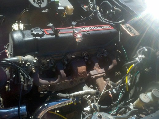

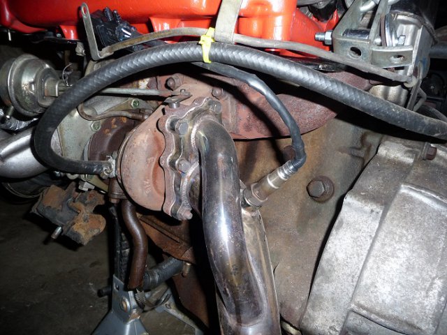

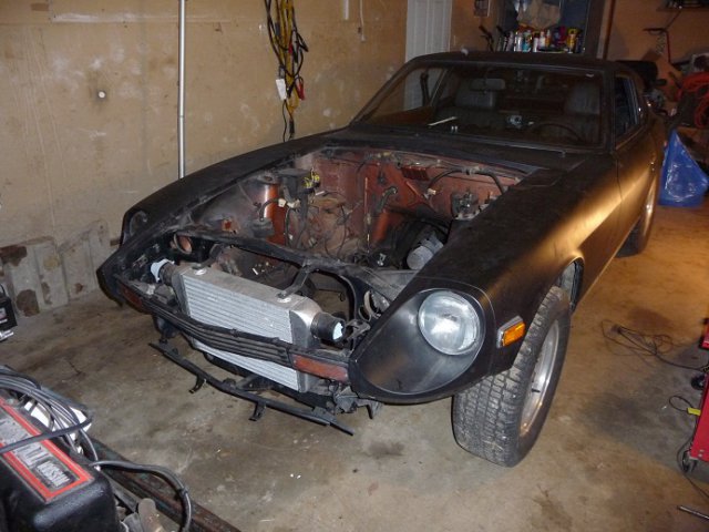

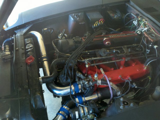

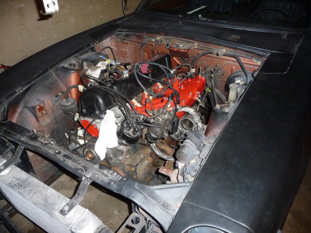

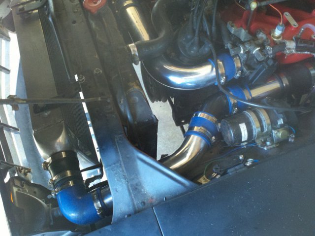

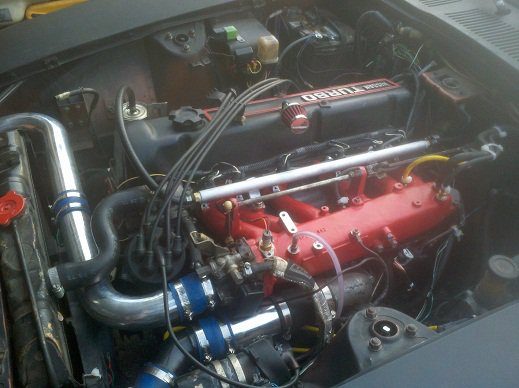

  1. Next step was the motor and wiring. So first I pullet the l28et from my '75, along with my MS1 and relay board. I needed to clock the turbo so while I was at that I tied up the turbo coolant lines and installed my WBO2 sensor. After a couple hours of wrestling with the motor it was finally in. Then I began to piece together my wiring harness. I installed quick disconnects to the engine harness to make working on the car easier. Next I attempted to install my 440cc injectors, The injectors wouldn't sit in the manifold so off the manifold came to be filed out. then I put in the big injectors and my palnet rail. Took the time to finish the intercooler piping as well. After the motor and wiring were finished it was finally time to get the car out of the garage and begin tuning. Also some pics of the completed car.

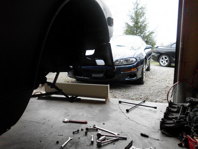

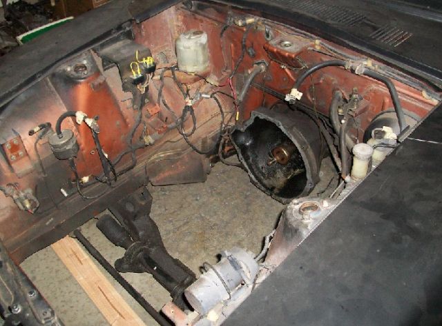

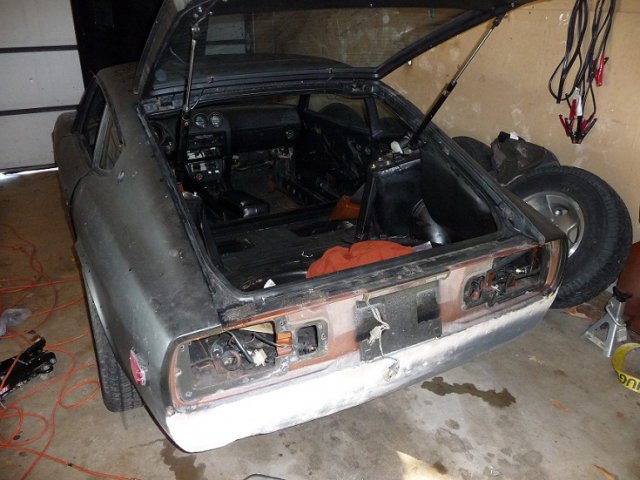

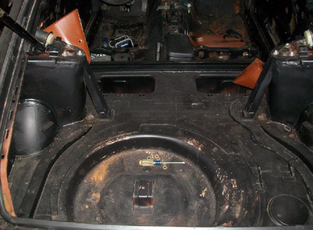

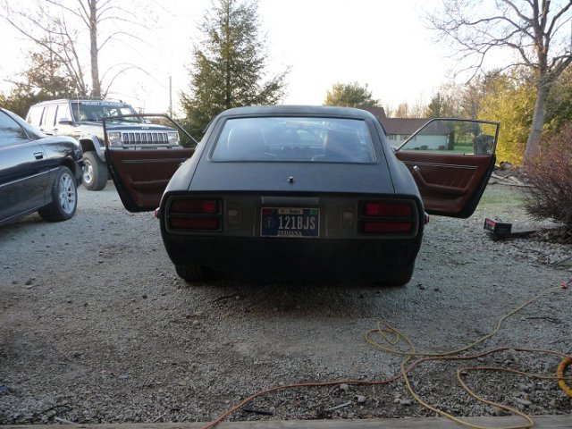

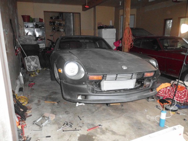

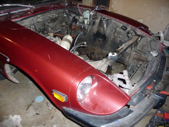

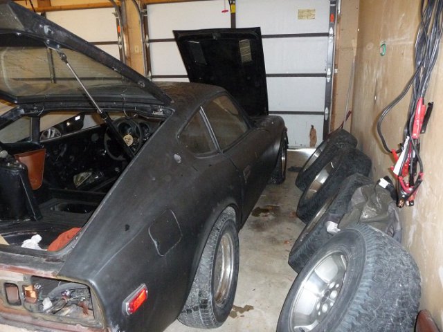

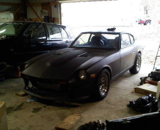

  2. Time for a massive update! The car has been drivable since March, but with school being insane and my internship at ford taking me back to Dearborn and five hours north of home I haven't had much time to update of work on the car for that matter. But here is my build update from December when I bought the car to March when I got it back out of the garage and drivable. I wouldn't say the car is finished since I am scratching my head at a possible RB25 swap in the hunt for more power of course. Anyways here it is! This was the car when I got it pushed into the garage, I need to add that I live in Indiana and that this build took place over winter break with one space heater haha. And as luck would have it when spring rolled around and the temps warmed up my dad found a deal on a propane heater. Of course by this time the cold of winter was behind us. Anyway, The car was a mere rolling chassis with sectioned strut tubes but an otherwise incomplete suspension. So the first step was to take all the suspension off of my '75 and put in on the '77. The sectioned strut housings are still in my garage and waiting on me to pull the trigger on some ground control coilovers. Money is of course a little tight right now, but I only have one semester before I graduate from Purdue and then I can start really building my dream Z. After the suspension was buttoned back up I felt that the interior was the next on the list. Mostly because I could put my space heater to good use inside the car. First I took care of some minor rust on the pass floor and rail. After that I installed all the carpet from the '75 and also some '90 jeep Cherokee seats. Then I installed my wideband and boost gauge along with my switch panel and pioneer radio. I also took the time to clean up the door panels and put a dash mat over the heavily cracked dash. next I got a new shifter ball for my birthday!

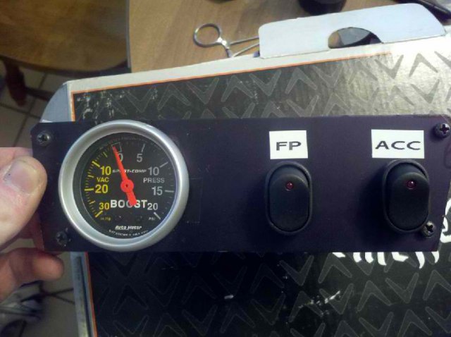

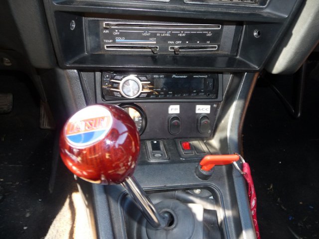

  3. Made from aluminium to house a single gauge and two switches to control my fuel pump and radio.

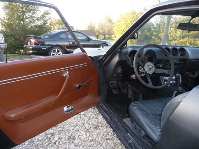

  7. IIRC the tach and speedo come out the front. The three gauges in the middle are secured by one screw each in the back, they must be taken out from behind. Remove the a/c bezel and you can see the fasteners.

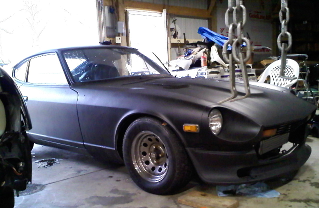

  9. I am in the middle of tuning and so far I have my idle and under load AFR's pretty solid. However, and this is a huge however, the car when I am cruising will not hold a steady AFR. It oscillates from 12.5 to 16.5 and will refuse to level out. I am using tunerstudio VE analyze live and I feel like my fuel map is pretty solid, but wether I try to tune manually or use tunerstudio I can't get my AFR's to hold steady. What am I doing wrong, or is there something I am missing regaurding the tuning strategy. Thanks for the help, Kevin

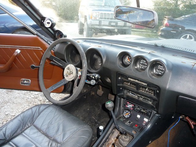

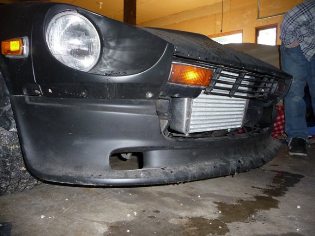

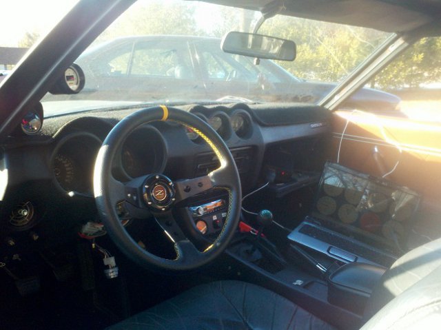

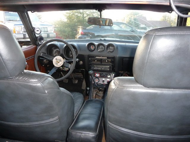

  12. The car is almost completly done! just a small section of the frame that still needs patched up as well as hooking up the tach and water temp gauges. Other than that all thats left is tuning. These pictures take you from when I purchased the car back in December through the complete build. All the suspension was taken out of the car and redone as well as the motor swap from the '75 2+2. The motor is a stock '82 l28et with a skyline turbo and now runs of MS1 v2.2. The interior was completly gutted when I bought the car but now has Jeep Cherokee seats, dash carpet, custom switch panel, pioneer radio and speakers, and boost, wideband, and oil pressure gauges. The car will probably never be finished since I am now thinking about the next stages of the build. But at least it runs under it's own power now and can be driven. Thanks Hybridz for all your guys help thoughout this build.

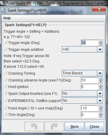

  13. PROBLEM SOLVED!!! Thanks you guys, it was the trigger advance that I had set wrong. Car runs just fine now. Now to tuning. Kevin
  14. If that is the case (the computer thinking i need it to skip a cylinder) my spark settings could lead to my problem. I will try it this weekend and let you know what happens. Thanks for the input.!
  15. Moby, Thanks for the reply i will try that out this weekend when i can work on the car some more. As for the settings i used were from this page: http://forums.hybridz.org/index.php/topic/47394-msns-extra024s9-settings-in-jpeg-format/ What exactly does the additon angle do? I'm not sure i completly understand the theory behind this parameter.
  16. Could my timing match during idle but vary after that. Could that cause the isssues I am seeing?
  17. I checked timing values and what tunerstudio says my timing is, is what i see with the timing light. At idle it is around 19* BTDC. The only problem i had with timing was trying to follow the install guide. I set it to around 50* and then set that value in tunerstudio. I then adjusted until the timing light matched what tunerstudio said. The problem i have though is my settings ended up being as follow: trigger angle (degree)----------------- 38 trigger advance ------------------------- +45 I know in the install sticky his settings are like 80* +45 I'm not sure why mine are so much different but it was the only way to get the timing at idle to match up.
