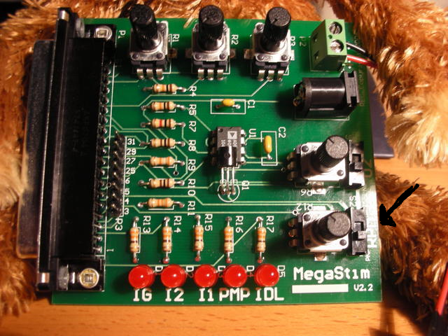

Sorry about how vague that was. If you look at the MegaStim, version 2.21, below the RPM pot there is a box that is a switch. The label for the switch flips from PNP to NPN. I have no clue what these labels mean or even what the switch is for but when i switched it the tach stopped working in Megatune and i can't seem to get my tach to work again.

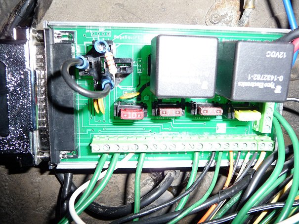

I have spark now!!! It was a pull up resistor in my fiddle relay that was overheating the HEI module and my Q5 transistor was also burnt out so i replaced it and now i have spark. I am now concentrating on the fuel side of the install. My fuel pump doesn't seem to want to start. It works if i connect 12v to the wiring harness but the relay board isn't outputting any voltage when the pump is supposed to be primed and when the car is on it also wont output any voltage to turn the actual pump on. Is there any relay board modifications that need to be made to allow the megasquirt to output a voltage to the fuel pump.

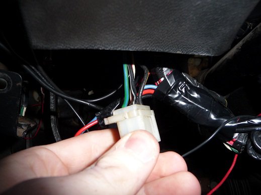

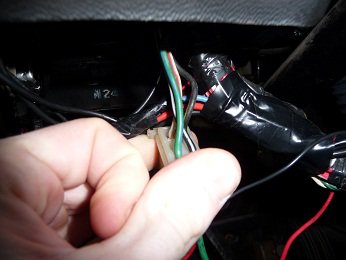

Sorry about the picture size. I didn't realize the space they were taking up. The first part of the install seemed very easy, I just followed the guide that moby wrote up and also looked at some wiring schematics from megamanual. In all of these they never really mentioned the ignition wiring, so i then pulled up factory wiring diagrams to see where the wires from the plug in the picture lead to. They went everywhere and anywhere it seems, switching colors and going into things I don't use/have anymore. This is why I was hoping to get some incite from you guys. Thanks for your response and sorry again about the massive picture file size. Kevin -

No body is willing to put in their two cents. I am just curious as to how you guys wired the megasquirt to the ignition switch on the steering column. -

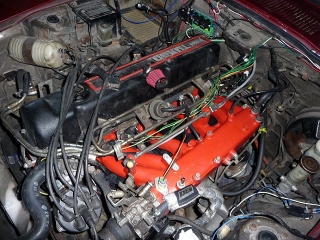

I have been trying to get my 75 280z running before summer comes around since i won't be home and will have no time to work on the car. I have a '82 l28et with n42 intake and attempting to install ms1 v2.2 into the car. So far i have the entire outside harness made and the resistor pack installed for the injectors as instructed by Moby's write up. I am using a gm HEI 4 to fire my coil and modified my relay board to jumper IDL to fidle. There is a picture of my relay board attached, It has a 2.2k pull up resistor and a jumper wire in place of the fidle relay. I am hoping someone could look at how I wired it and let me know if i did it correctly. he major problem i am having is getting the ignition switch wired. In most of the write ups I've read and on the DIY website all the ignition wiring only shows a key hooked to 12V and to the relays. I have no clue how to wire the ignition switch into my relay board or what wires to connect. There is the 4 wire plug that comes off the ignition. The wire colors are: blk/white, blk/yellow, white/red, green/blue Can someone please help me with this wiring and how to connect it to my relays on the relay board so I can hopefully try firing the car up this weekend and maybe get some tuning in before summer starts.. Sorry for all the questions I just want to make sure to do this right.. Thanks for all your help guys.
