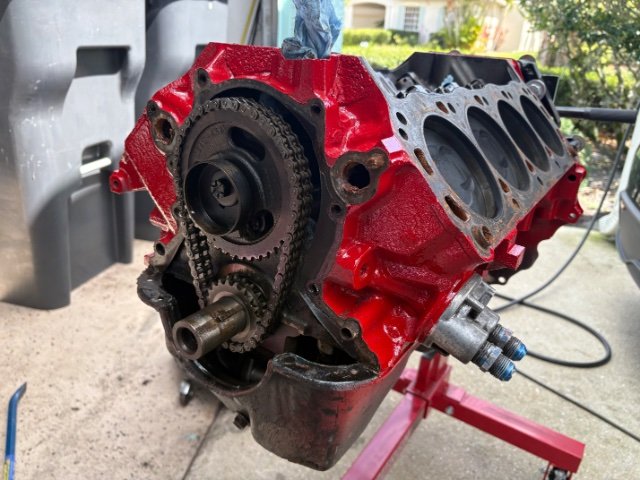

Got timing cover painted. Spent almost half the day dealing with a bolt on the timing cover/water pump that had broken off in the block. Tried all types of extractors, ended up having to drill it out and re-tap it a size bigger. Got the oil pan off and installed new pump and pick up for the new baffled oil pan. Got the main seal on, set the timing cover on and called it a day. -

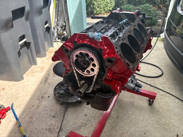

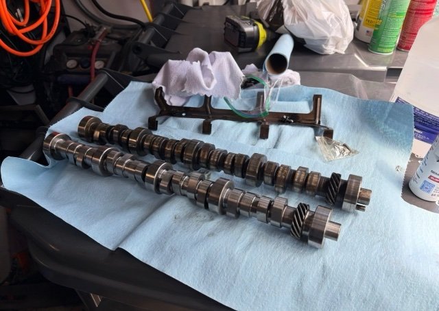

Cleaned up the block, got it primed and painted this weekend. Replacing pan and timing over, will paint timing when it gets in. Now I can get new parts on the engine, I’ll start with swapping the cam next weekend. Also ordered the TKX transmission should be here this week. -
