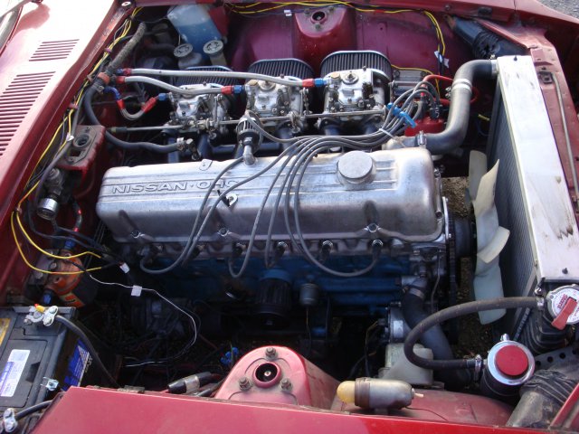

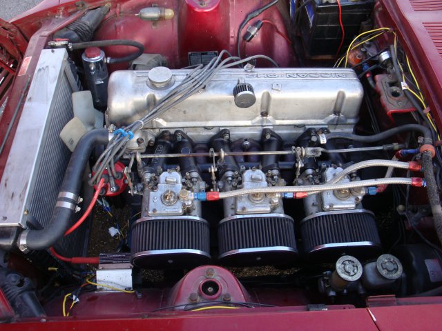

More than one way to get to the 35 post count req. for the classifids before my "area 51" post spam is deleted... Here's my 72' 240, daily driver, sole method of transportation, constant money pit, and mistress. Just don't zoom in on the dark electrical pit of doom that lies just below the spark plugs 5-6, in the 2nd last pic.
