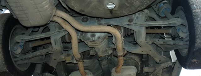

first real drag race. 12.97 was the fastest pass I made. That was with tire spin through first and second and a horrible launch. BONE STOCK 5.3l l33......... take that ls1 trans am... lol Next step, TRACTION. I found a 94 q45 at the local pick and pull and grabbed the whole subframe for $90 bucks with low miles. I plan on running the entire rear subframe with cobra r 17x10.5 wheels on the street with supra 16x9 with slicks for the track. I think thats my best plan. Guess I better be nice to those 315s on the street.... The picture is of BRAAPs for sale post but I figure he wont mind. Thats the same setup I will be running soon. I also plan on running the imsa widebody kit. Turbo is eventually in my future so I will be needing all this. Thanks for watching. -
Formerly Evil Z lq4/t56 widebody 240z
77turboz replied to acidrain088's topic in Gen III & IV Chevy V8Z Tech Board
Wow. Thats exactly what I plan to do with my car........ I will be going with the q45 rear but other than that. Definitely subscribing to this. Maybe we can keep each other motivated. The second pic is what Id like my car to look like. -

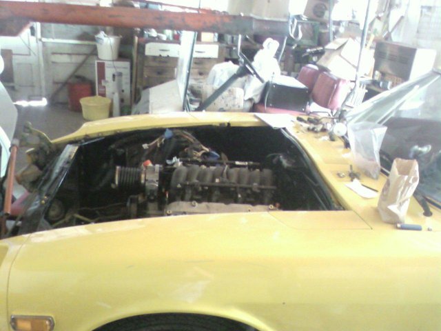

Ok, time to update. Parts are starting to fly in and heads are rolling. I got the car tagged, Im waiting on my personalized tags to come in. I came home from ND to do a little work on the car last weekend. We found what was causing the issues. The computer is picking up a funny pulse from the speed sensor. I unplugged the vss and now it idles just fine. I figured it out when the car would only idle hunt when moving, disappear when stopped, then come back again when moving. I have no idea what is causing it yet, ssp thinks that there is a mechanical problem..... I think the screwed up the tune. Either way, they have no idea. Well, they did have some ideas but they were bs. They thought that I had a ford or dodge speed reluctor ring. Checked yesterday when a snapring came off the mainshaft and caused 6th gear to stick. The reluctor has 17 teeth which is normal, no chipped teeth or anything (another idea of theirs) so Im back to the drawing board. For now, I will just leave it unplugged. I bought an electric water pump to eliminate my belt issue. Now, I have an alternator only setup, which looks sweet. My bro is getting the exhaust done at the local shop, went with a warlock bypass muffler. I should have went bigger since I plan on going turbo later but for now, this will do. I also bought a full set of gauges, they look great. Im not sure what is in store for the body, I have a little rust over the rear wheels so I was contemplating going with a IMSA widebody kit but not sure if thats what Im going for with this project. Other than that, hopefully pics will follow soon. And a video of the exhaust. Thanks for watchin...... -

Ok, well its been a while but everything is fixed now. I am running the 411 pcm, 04 truck tb, 04 truck pedal and module, and SSP wiring harness and all is well. They figured out that the pedal was no good and the tb I bought on ebay for 30 was no good (go figure, damn I hate my cheap ass). So now, Im awaiting my new tb so I can get rid of a nasty idle hunt problem. Then, she will be good to go. Im gettin 4k back on my taxes so all is well here. My brother is doin all the work on my car now that Im stuck in the Great White North of North Dakota. Soon as I get some time off, Im gonna get back home and drive this beast again. I have already driven it once, but it was icy so I couldnt discover the true potential yet. But man, is this thing fast. I think I do have a slight grind in 5th gear though. The tranny was rebuilt so it may just be my shotty shiftin. As soon as I get new pics I will post them up. Thanks, Drew -
