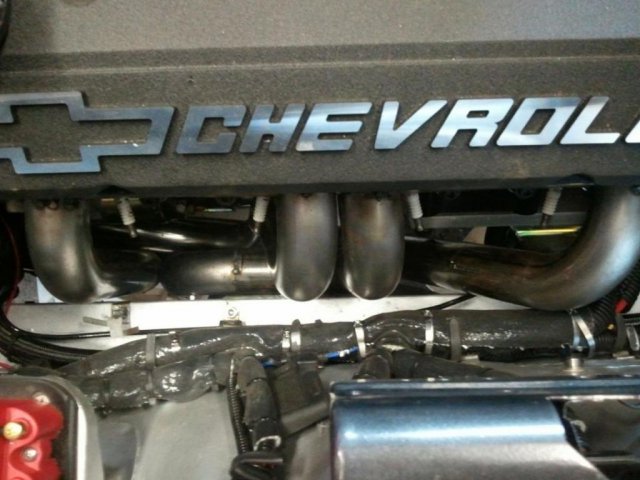

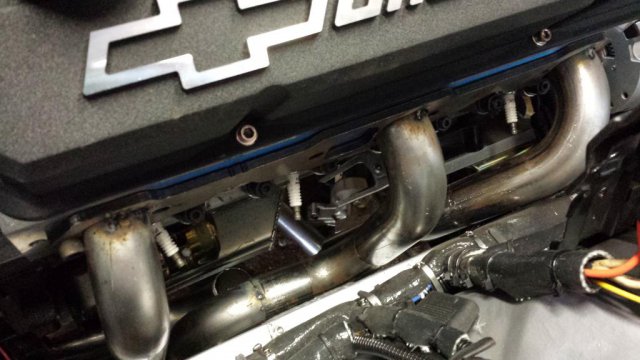

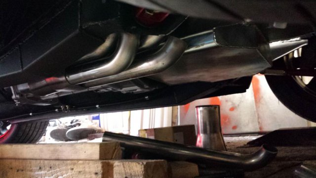

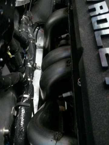

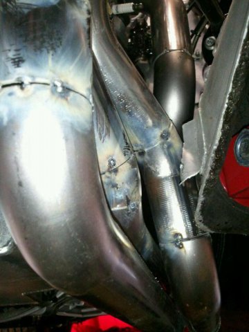

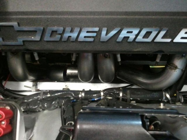

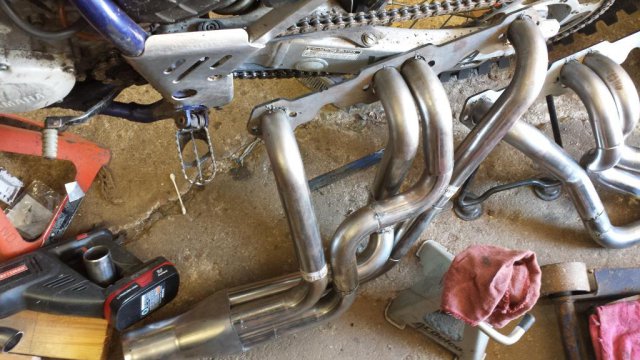

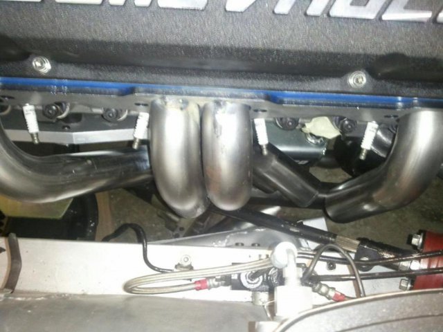

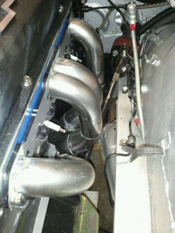

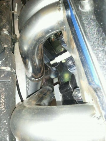

  11. I didn't really look at it that much I actually not making them myself. But there tucked up as close as they can be. I will post more pictures once I get them back from final weld and coated.

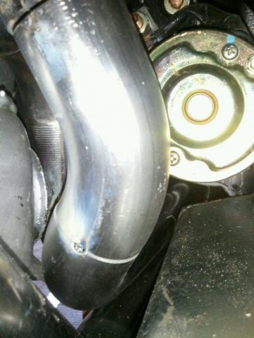

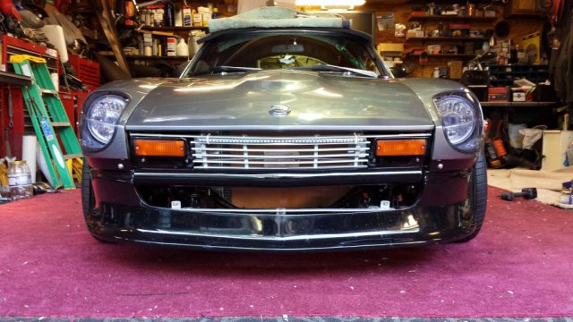

  12. Figured id share my custom headers i had made. 1 3/4" primarys Heres some pictures.

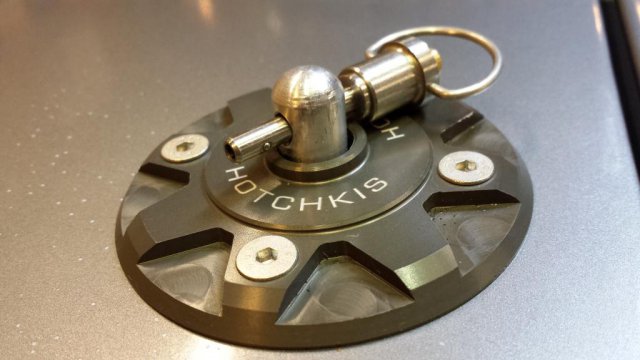

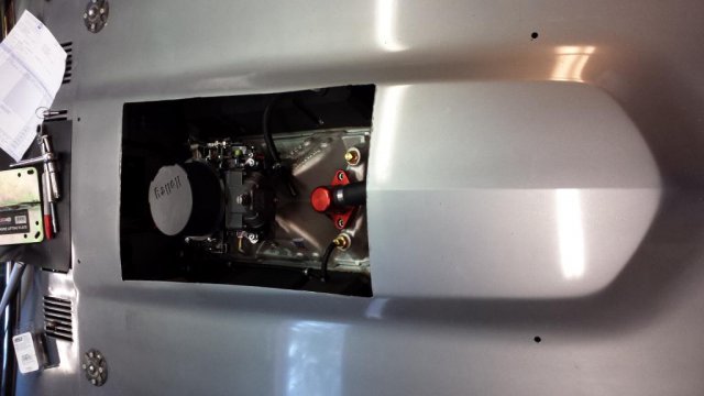

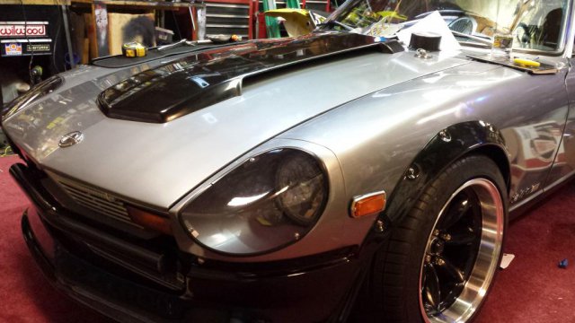

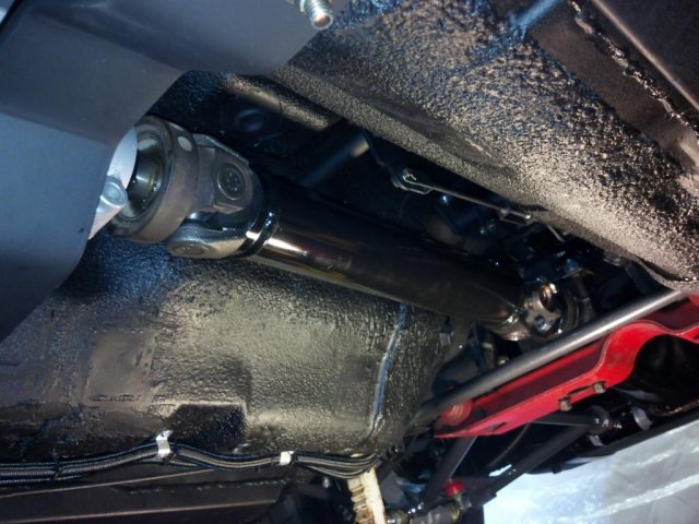

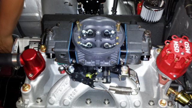

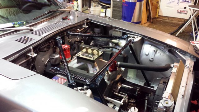

  13. So now that the motor is in I pretty much got everything wrapped up. Finishing up with some odds and end. Heres a list of some parts that got put on since last update. Custom chromoly driveshaft, the driveshaft shop shortened axles, meziere 55gpm water pump, MSD Dynaforce alternator, AFCO radiator, Derale radiator fan, Holley ultra hp 750 cfm, competition hood scoop, Hotchkis hood pins, SSBC vacuum pump. Also currently in the process of making custom headers. Thats all i can think of for now heres a few pictures.
  14. Been looking through a bunch of threads and can't find any pictures of custom headers made on a sbc Z. Anyone out there have pictures?

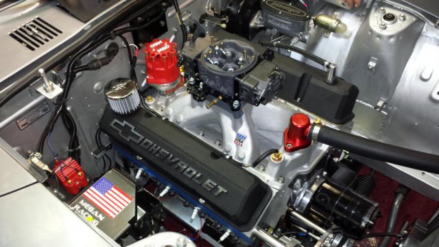

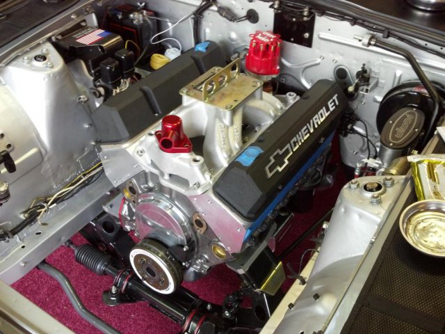

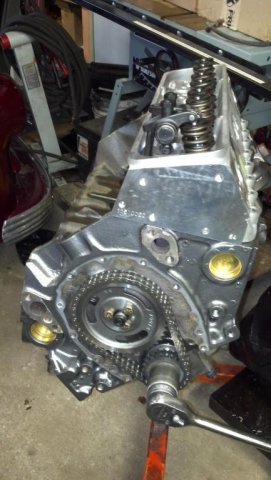

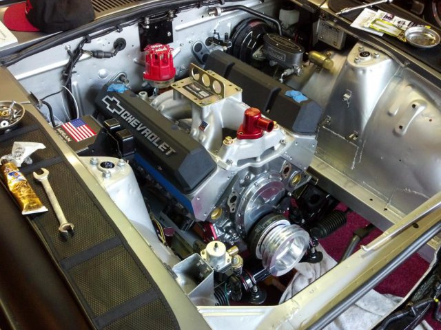

  15. Finally got the motor in! Fits nice went with a road race pan and going to get custom headers made. Installed carbon fiber braille race battery. Got my MSD digital 6 ignition hooked up. Just about wrapped up the interior besides harnesses. Just waiting on a few things and she should be running in no time! Here are some pictures of the motor being built and the other things I stated before.

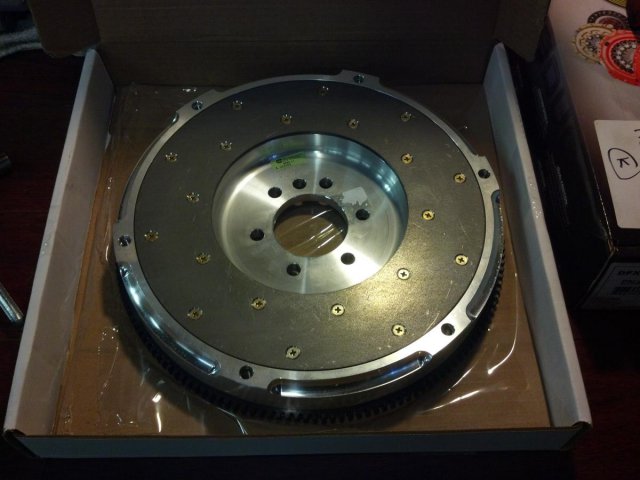

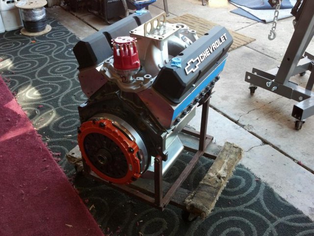

  16. Got some more parts including centerforce clutch and fidanza flywheel. Some projector headlights. New radio is in just waiting on passenger seat and interior is done. I motor is almost done being assembled should have it in the car I'm about 3-4 weeks

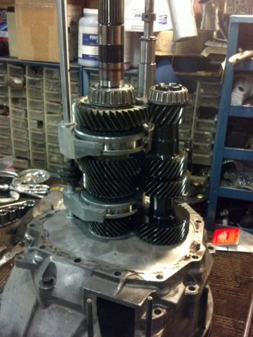

  17. Although you do need to bring it to a machine shop to press off/on the 1/2 3/4 syncro assembly it cost me $100.
  18. I bought a manual on ebay helps a lot but I thought it was pretty easy. My trans wasn't to bad I didn't replace any bearings so I didn't have to shim anything either.

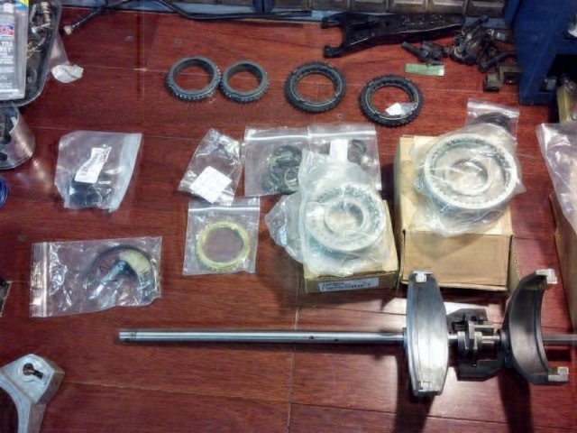

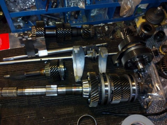

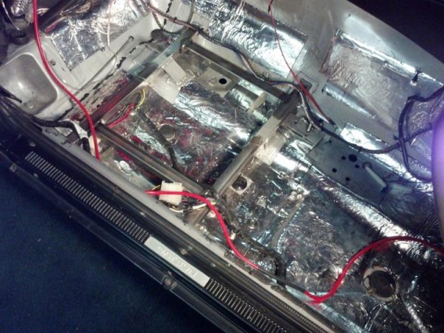

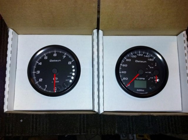

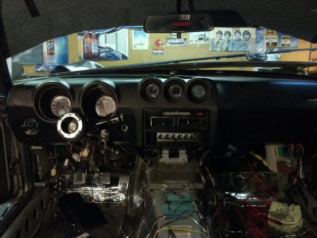

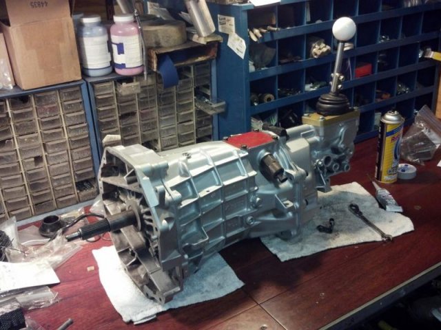

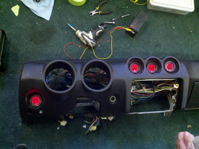

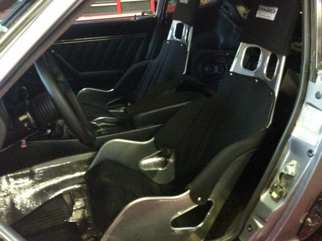

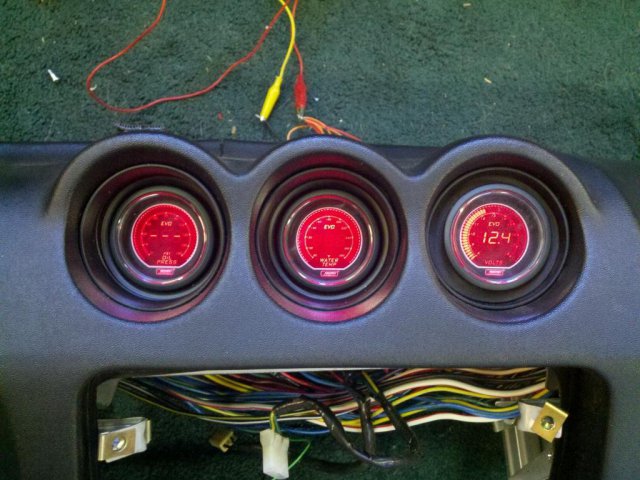

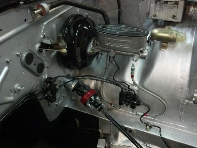

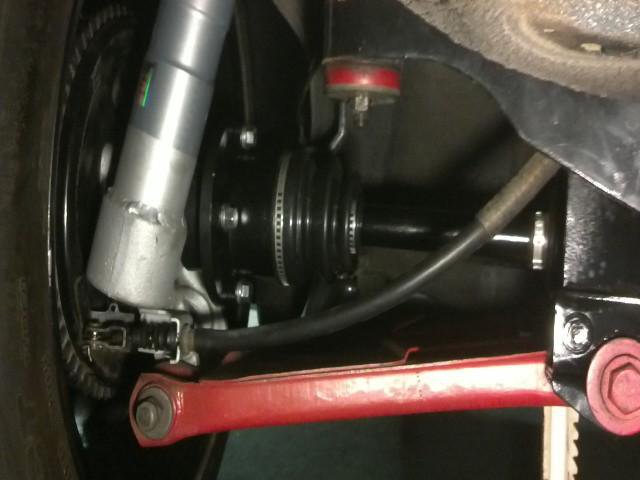

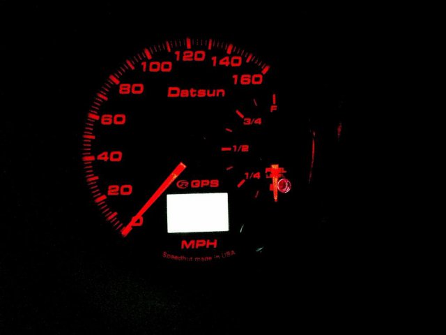

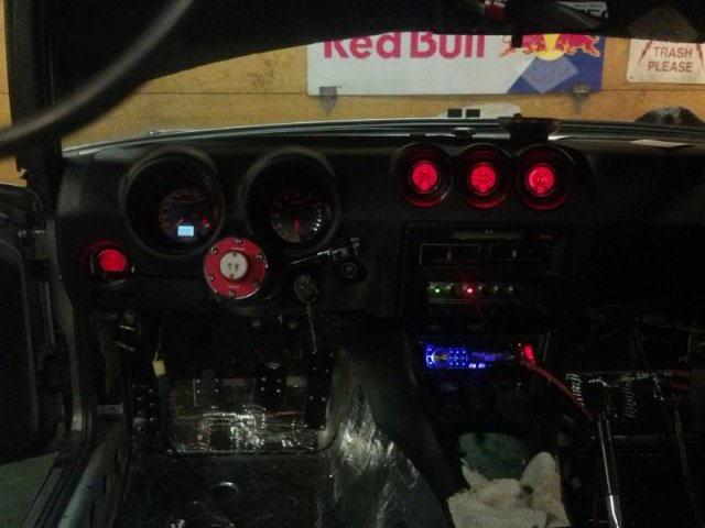

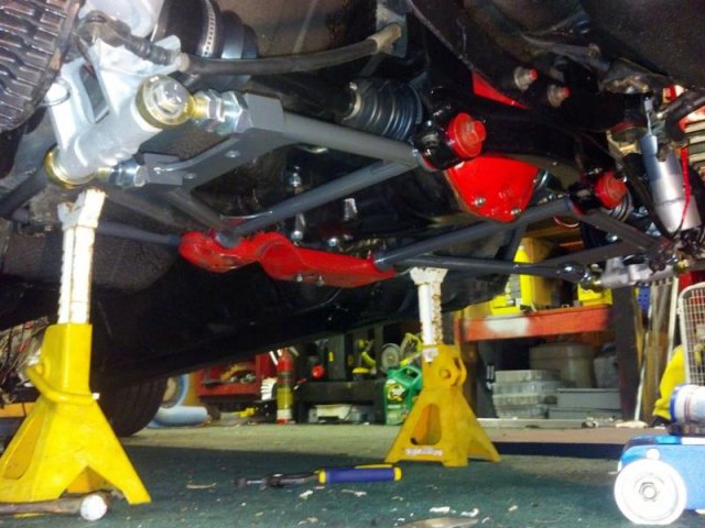

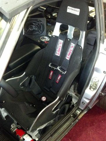

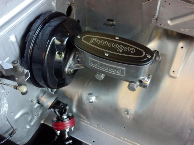

  19. Almost forgot about this thread .... heres an update, rear end is finished after waiting months for my adapters 300zx cv axles are now in. Brakes are finished custom brake lines by Pirtek hoses also threw in a Wilwood master cyl along with a clutch master cyl as well. Finished my gauge setup with speedhut tach and speedo, then prosport gauges for everything else also install a dash cover that turned out pretty good. Got myself a momo steering wheel and a ultrasheild aluminum seat actually is really comfy atleast to me it is! Finished all sound deadning on both driver and passenger side. By now pretty much every bolt has been replaced with stainless or grade 8. Rebuilt my t56 transmission with stage 2 upgrade kit from thegearbox.com very happy with there kit. Now waiting on motor to get assembled almost done and clutch is ordered. Here is some pictures.

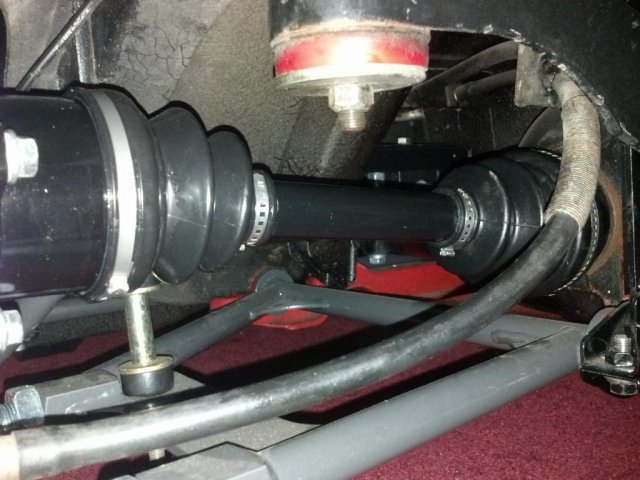

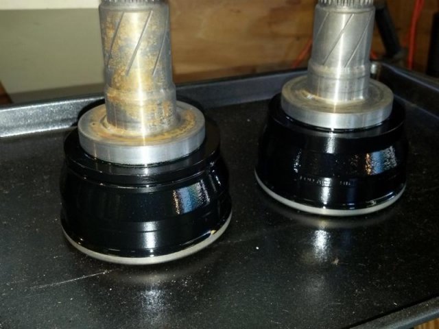

  20. So I recently got in my stub axles and cv adapters from modern motorsports (after waiting 3 months) decided to replace wheels bearing while im there. So i go ahead and install them and find that when tightend down they are stiff and do not spin well and effort is actually needed to spin them. Also tried taking out the inner seal because I thought that the cv adapter was rubbing on that and still no luck. Could there be a problem with these axles? I even tried the old bearing and same issue, triple checked that all of the bearings were seated fully. Im out of ideas.
