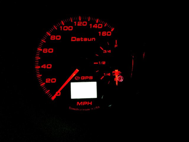

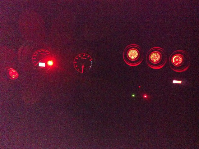

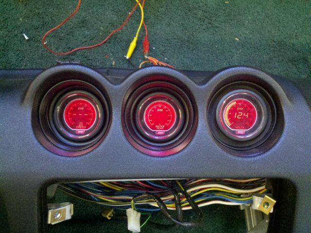

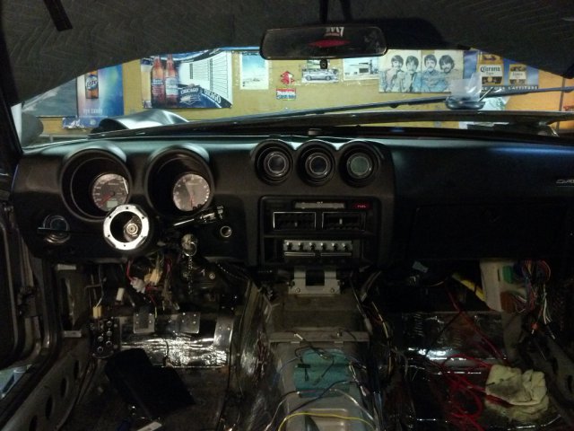

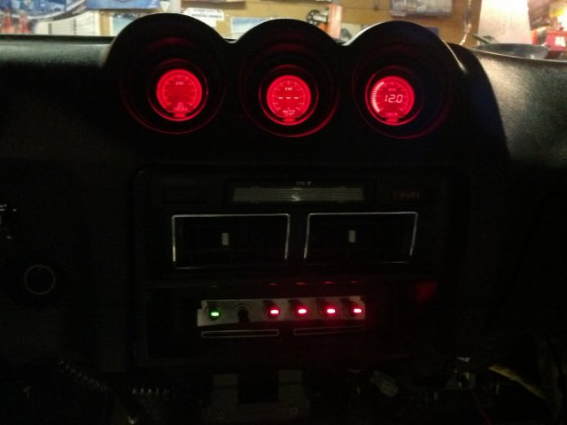

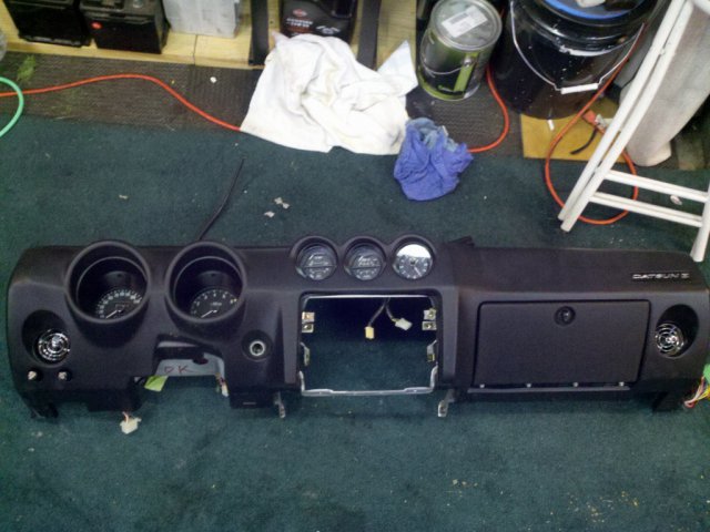

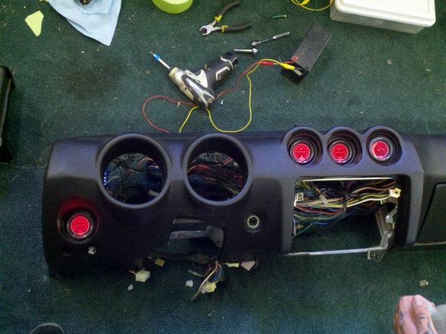

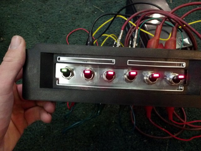

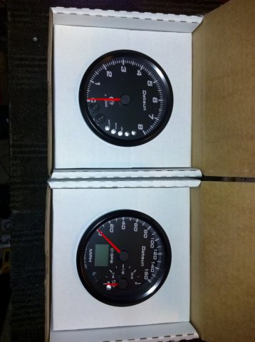

I can actually dim them theres a little dial on the back. There really no much brighter then the speedhut gauges just look like it in the picture
Looking for 2 gauges working or not has to be the dual, either fuel/volts or oil/water from a 280z or 260z if same gauge. Thanks David

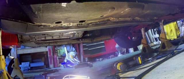

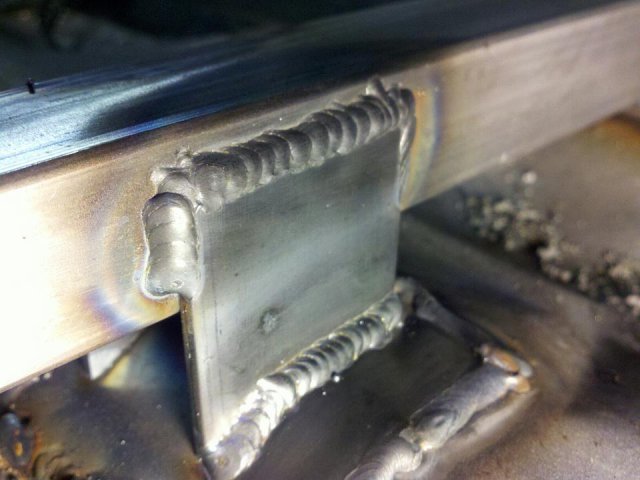

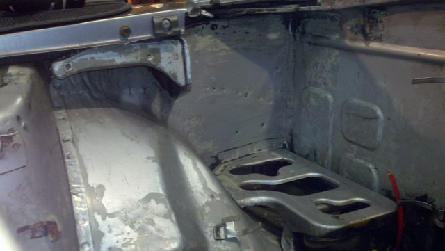

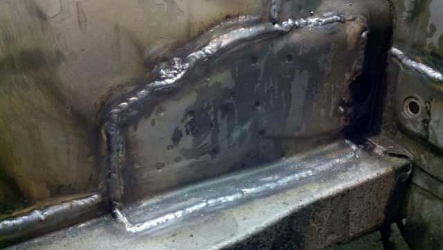

Well first on the bottom side where the sway bar mounts to I welded a plate to the frame rail to reinforce that mount then drilled the two holes straight up and made the part that goes down to the frame bolt through the frame to the sway bar bolts. If that is confusing I can take a picture if you would like. -

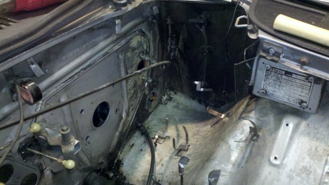

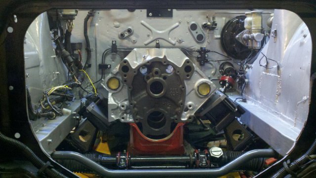

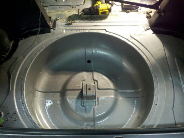

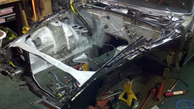

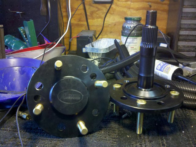

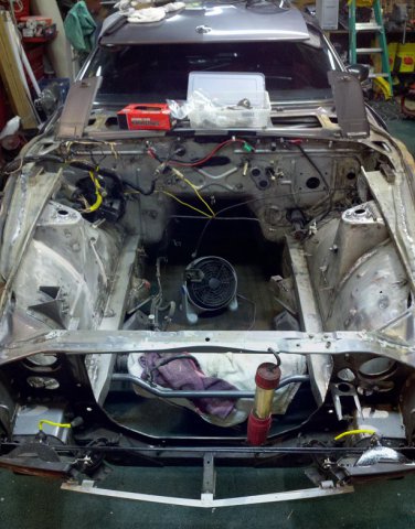

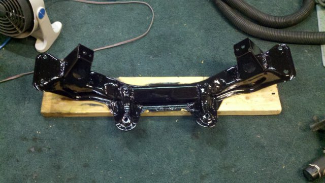

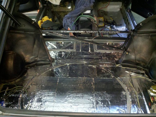

Havent updated in a while here are some recent pictures. Bad Dog frame rails in progress, custom seat brackets finished, roadkill sound matting, por-15 all the floor pans, MM Stub axles (just ordered cv adapters). -

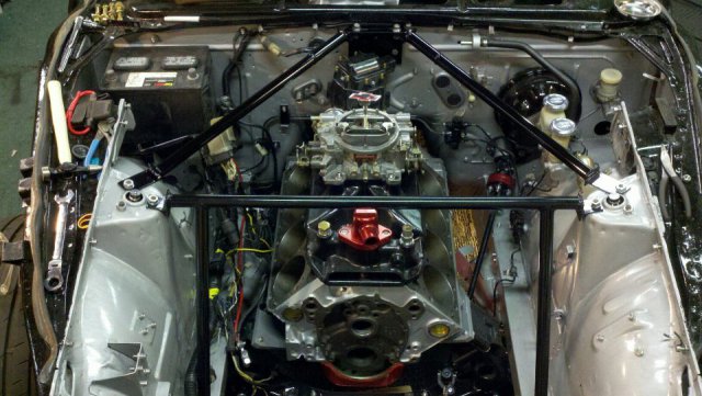

My strut tower brace
egzlilgituarboy9 replied to egzlilgituarboy9's topic in Brakes, Wheels, Suspension and Chassis
It goes through the frame rails. Figured if i had it all one piece it would be a PIA to remove it as one big thing. -

Thanks, going with a 383 Stroker all forged internals. -

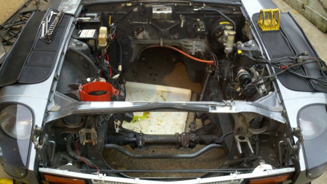

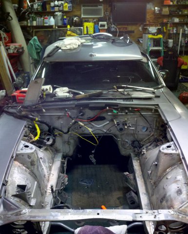

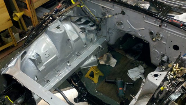

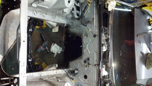

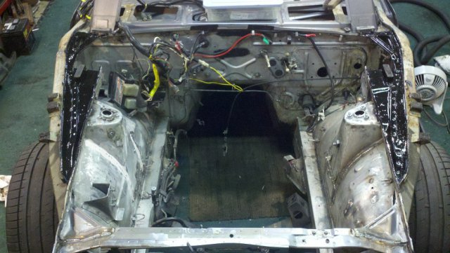

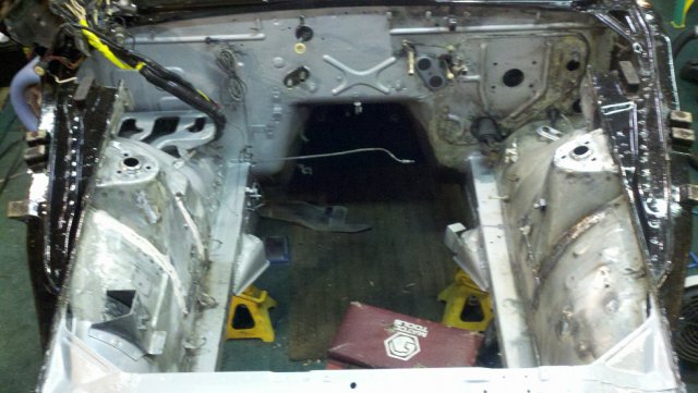

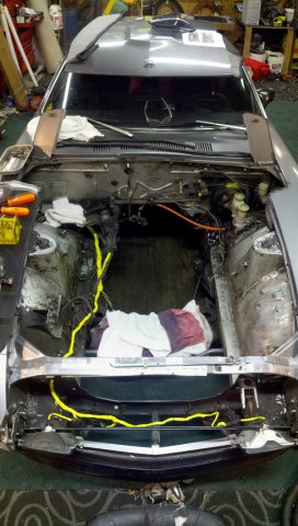

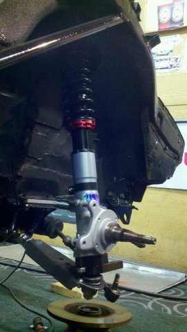

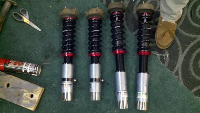

Been working on my car since fall and have yet to start a build thread. My plan is to but a good streetable car that for some weekends at auto-x and and few runs down the strip so here is where i'm at right now. Rota RB's, 4x4 calipers, drilled and slotted rotors, megan coilovers, MSA sway bars, TTT front control arms, AZC steering knuckles, OBX LSD, TEP rear strut tower brace, custom front strut tower brace, reinforced sway bar mounts, seam welded front half so far, stripped engine bay and repainted i'm sure there's is thing i'm forgetting but its all I can think of right now. Here are some pictures.

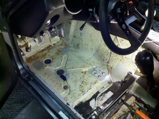

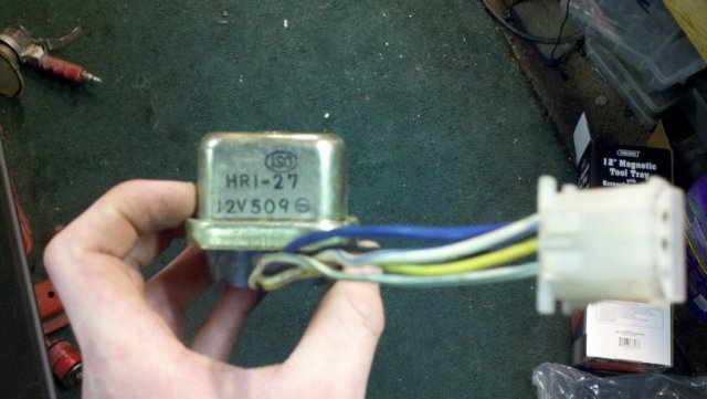

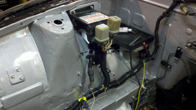

under passenger seat on the floor right by the trans tunnel. 1976 280z 4sp manual trans -
So I was working on my car and had the car on not running but on and I was taking out my passenger seat and felt this thing was pretty hot. What is this component? and should it bet getting hot?
