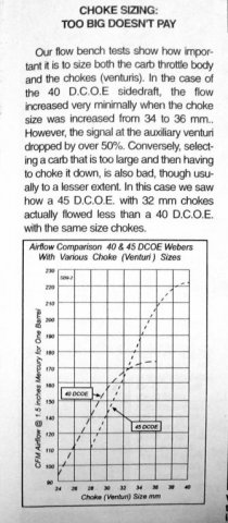

Nope. The image came from the internet, but I own the book as well and can confirm that's all we get. There's one other potentially useful graph, which bases venturi selection on cylinder displacement and peak horsepower RPM. The numbers on the chart are lower than what road race engines use, so it too is more interesting than useful for our purposes. I feel the book(s) could provide a LOT more charts, to include distinction between "street" charts and "maximum performance" charts. In my experience those that tinker on carbs do not value books very much past initial familiarization, because, well, that's all they're useful for. (EDIT: In practice, what matters is what works, not why. "Why" fosters improvement; knowing what works fosters repetition.) Perhaps this is part of why the carburetor books "lack" tangible, scientific data relative to other industries in the information age? (EDIT: Yes, fuel injection, I know. Carbs are still purchased new!) Carburetor "theory" without solid carburetor "data" decades after the theory was written? Hard to improve if we never circle back with upgraded, modern perspectives. Doesn't seem like the industry is interested in such a thing, either. Sounds like our government! I digress... -

Anytime! Regarding the 40-41mm venturi, I don't expect much difference either. I still reference this Weber chart, particularly the note about aux. venturi performance. (EDIT -- comment about carb body's exit removed, as I was mixing up the numbers with the 40mm carb body.) I have no idea how accurate my "209 cfm per cylinder" flowbench measurement from yesteryear is. A 5-10% variance between that and the chart would translate to a + 2mm venturi size accuracy. That's a blind guess, so it renders this chart conceptual. It's still nice to know that, in theory, around 39mm you're starting to get all that you can out of the 45mm carb body. Road testing will quickly determine which > 39mm venturi offers the most mid-range drivability, no doubt. -

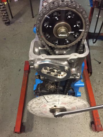

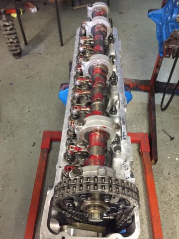

If only 1 in 6 can handle the 3.1L overbore, why don't we hear warnings from the unhappy owners of the other 5 of 6? Interesting claim, but I'm with Steve -- I don't buy it either. I don't think our community would be silent on that kind of a failure rate. Gettin' close and looking good! Head and valve train assembly complete, only minor assembly remains. No idea when the engine dyno will be scheduled... -

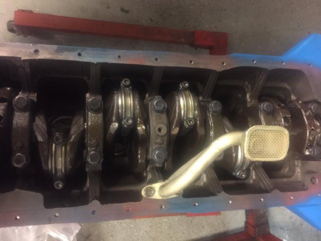

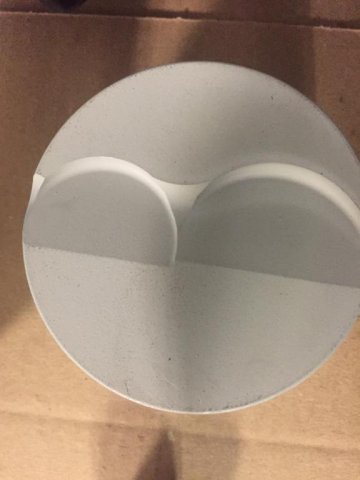

zredbaron replied to zredbaron's topic in Nissan L6 Forum

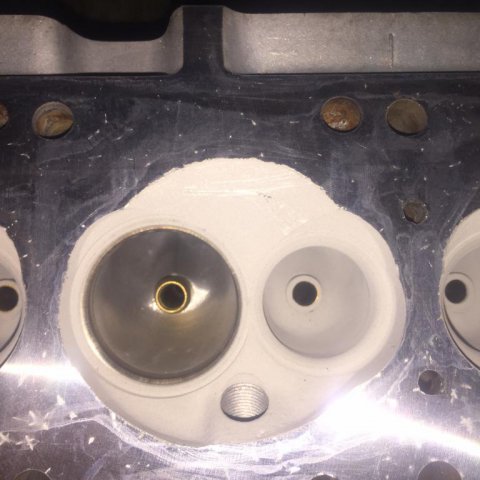

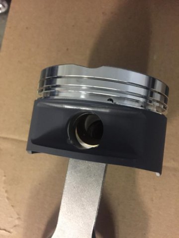

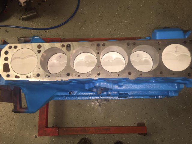

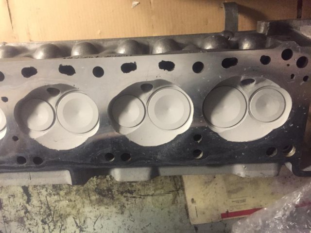

Getting closer. Block is assembled. Pics of coated pistons and new L24 rods below (Eagle). I don't know the weight difference yet. Also included are pics of the coated E31 head. Combustion chamber, valve faces and exhaust port all received a TBC (thermal barrier coating, SwainTech). Not yet assembled. Sounds like coordinating a window to use the engine dyno is proving difficult. Best case another delay, worst case chassis dyno only. Not sure what to expect. At this point, it's been so long (again) I'd just assume wait until the engine dyno can be utilized. "August?" I think I've busted my budget by about 300% or so, too. Couldn't have afforded all this without the year of waiting to pay for it, wow! -

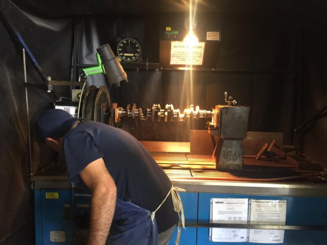

Well, as unpleasant and uncomfortable as it was and still is, I paid an exborbitant price for a used LD28, and the ball is once again rolling. The new-used LD28 passed its magnaflux test and will be balanced / polished this week. Main bearings are being sent off for coating now that the journal sizes are finalized, too. So... barring any unforeseen challenges, final assembly and dyno tuning are all that remains. I don't have a date set yet, but it looks like there's a decent chance that "July 2016" might be the month I officially get to try again! -

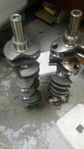

Slow but steady progress: billet crank is out, stock LD28 it is! The prospective billet crank finally arrived at Rebello. Dave's assessment: "It's a nice crank. It's not one of ours... but it's nice." It's made of solid 4340 and arrived knife-edged. All parties were surprised that the crank weighs in at 51 lbs, with stock cranks coming in around 52-54 lbs. The vendor for the crank: Thomas Thorman of Sugar Hill Speedshop (GA), (678) 546-6055, https://www.facebook.com/Sugar-Hill-Speed-Shop-1001732356563108. I spoke to Thomas; this is a new part for him and he is still getting the details (mods?) up to speed. I'm not sure what his plans are, but the price I was quoted in its current, raw form was $2,575, "pre-balanced within a gram." For me, this is too much cash for too little performance upgrade at this time. I want more strength, less mass (or improved CG) and more stroke for that kind of money, but that's me. Below is a picture. On the left is the new crank in question, and on the right is a Rebello crank for his 3.2 kits. Really makes a case for Dave's bottom ends! Maybe one day, okay very probably, but not this year... That said, I still rely on experts, and oversights continue to cost me a lot of time and money. Had I known my crank was shot six months ago, I wouldn't have ordered custom pistons and would almost certainly have purchased a 3.0 or 3.2 bottom end from Dave knowing what I know now. I sincerely hope my experience is helpful to someone in the future. -

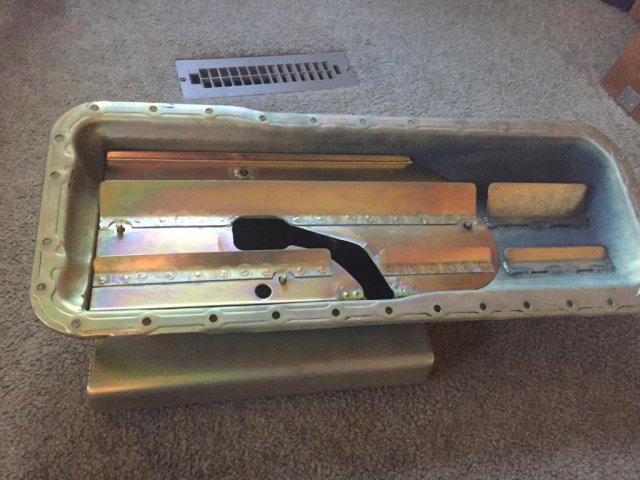

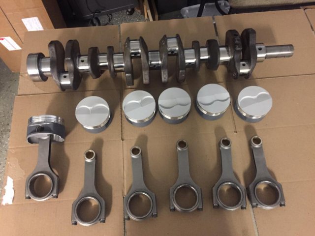

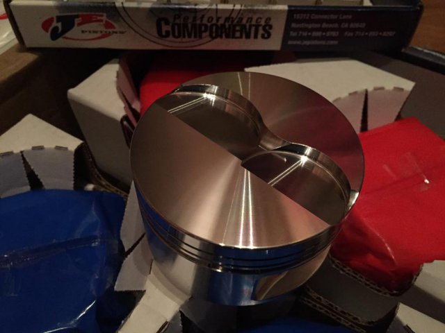

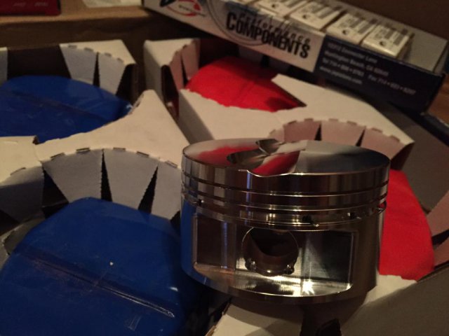

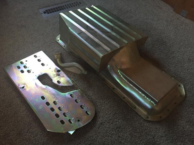

Updates are slow this year... JE pistons received. Pics below. Mock assembly went well. Rocker arms received. DP oil pan received. Pics below. (Wow!) Coated: head (CC and exhaust port), piston skirts and domes, valve faces, crank bearings Valve spring retainers from Kameari won't work. Joe ordered custom dimensions from Isky, I don't have the numbers at this time. (I think the Kameari dimensions didn't work because I'm using outer springs only.) Outer valve springs received 3x45mm DCOEs with Cannon Intake received Waiting for confirmation: Crank repair and rebalance Block bore/hone to match coated pistons ("new" block) Intake manifold port match (45mm) It's been a long year. Targeted engine dyno date is June 10.
