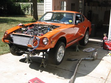

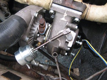

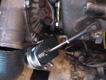

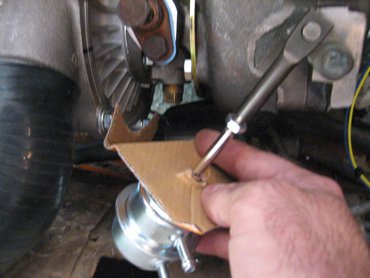

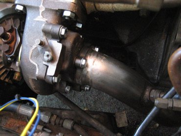

Just for data, I ended up using this turbo and it fits with a stock turbo intake and exhaust manifold. There is some conflicting info on the board but this setup needed a 1/2 inch spacer on the exhaust manifold and a little grinding on the compressor housing. Longer mounting studs from Mcmaster carr were used. Another problem was that the nissan factory four bolt downpipe mount needed to be converted to a 3 bolt flange and the waste gate actuator needed a fabricated bracket to work on this setup.

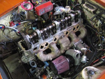

Been searching but I can't seem to find out what to do with cam timing when swaping heads. I have a 280zxt with a p90a and before removing the head I found TDC on number one and marked both links of the timing chain and sprocket. Well as soon as the head came off I noticed my #2 exh valve was pretty damaged. I don't feel like putting any money into this head so either one of my p79's or another p90 will go back on. Here is my question: When putting a different head or a different model head (p90a to a p79 for example) back on this motor is it all the same as long as I put the same sprocket on a different head? Just line up the marked links and use the #1 hole as before. Thanks, I imagine it is the same but never heard anyone discuss it.

Thanks everybody. I will isolate the alternator like z-ya said. Currently running 32lb high impedance injectors. On my last datalog (from a little while ago) it was the voltage that seemed to vary a bunch even when the alternator was charging. Btw, the car runs great. I'm really happy with the install and appreciate all of the help that I've gotten over the last 6 months or so. For right now I've limited boost to about 10lbs. here is what i'm running: 280zxt using an 82 dizzy wire per moby's/diy's instructions for MSII t3/04e .63ar (will not fit without a spacer) 32lb injectors/pallnet fuel rail at 45lbs a pete down pipe from this board 240sx tps -
