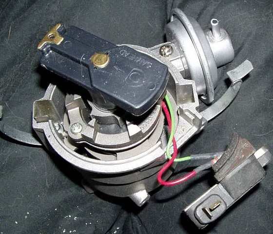

D6K8 is the type of dizzy it is...'79-'80 280zx. It would have originally used an e1280 module. Obviously it's been modified so no it isn't a factory splice. If you are going to use an e1280 module you'll need to pull those connectors off and see if they will fit the terminals on the back of an e1280 module. If not then you may be able to modify them. The connectors used to connect the D6K8 pick-up coil and the e1280 module are smaller than normal spade connectors. It had to have used some type of IC module but that's irrelevant now. You can use an e1280 or an HEI module. Personally I'd rather use an HEI module but there are people who will disagree on whether that is best. And ultimately it's your choice. The dizzy in my photo is a rebuilt D6K8 with an e1280 so that should help you if you decide to use the e1280. There is some info on this page that might help: http://www.jrdemers.com/280ZX/distributor/distributor.html
It's a D6K8 so it is what you wanted. The wires coming from inside are from the pick-up coil. Where do the wires go now?
