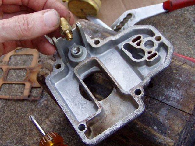

I finally got started. Two odd things I noticed. On two of the carbs, gas squirted out when the pump was depressed. The other one...nada. It had gas in the bowl too /shrugs. The other thing...the needle valve seating had no "gasket" as the manual calls it. I was hoping to ID the new one by looking at the old one. It's got to be the big silver one in the pic above. I'll check the next one to see for sure. Also I'm thinking I should leave the spindle assembly alone since it seems okay and I've heard it's not something to be messed with unless it's definitely got problems. True? Also...is the auxiliary venturi retaining screw hidden under a brass plug? The manual isn't clear on that.
