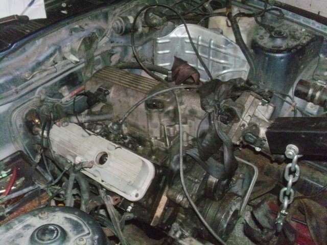

  4. I know this is the section pertaining to sbc v8s but im swapping a series II 3800/4l60e trans into a Datsun 280zx. I have the drivetrain bolted into the chassis but i have a few general & 4l60e trans related questions. 1st for everyone w/the starter on the driver's side did you make custom battery, alt & starter cables? 2nd on the transmission tail there is a connector w/purple & yellow wires coming from it that run the gamet of the harness, im guessing it the VSS, unfortunatly in my harness these wires are missing. Does anyone know how to hook this up? 3rd does anyone have explaination on how they hooked the mechanical throttle cables up to the Z pedal? 4th i heard a rumor that ppl use a v8 torque convert to allow more stall in performance applications using the 4l60, does anyone jave any insight regarding this?
  5. I have extensive exposure to the lc2 or as its commonly known the grand nat & TTa motor. 1st they are great and make a ton of power with minimal mods invested. Next the lc2 3.8 has NOTHING in common w/the sbc and are very diff from the sy/ty 4.3. The lc2 3.8 comes w/a 200r4 auto trans the 4.3 has the 700r4 & 4l60. The 4.3 obviously make more stock power but the 3.8 are better for performance kin the higher numbers. In a z32 id go lt1, lsx and not the LC2. If you have to use a 3.8 id use the 3800 series II from a gtp.

  7. Id have to ask what year and series 6.0 your using? If its from the lsx series you might need an adapter to mate the t5 behind the lq4. Id look for an t56 or 4l60/4l80 from a later model car/truck. Good luck, cochise.
