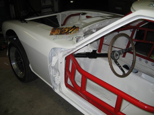

If you don't continue the diagonal bar to drivers side head, your never going to pass tech anywhere, and anyone who knows anything about safety would tell you if your cage was ever to be used, you'd probably be crushed due to lack of support for the top hoop. -
roll cage start open to advice (not 56k friendly)
73240z replied to rdsk8ter's topic in Fabrication / Welding
Looks like your on a good track. Are you having the side bars go out past the doors? In otherwords, are you going to gut the doors? There might be limited room if you do those side bars without gutting the doors, but its a good side bar design. Same as nascar, if they use it, it must be proven safe... Similar to the ones I did. -
Keep in mind your height, if you are anywhere over 6 ft, You want to keep in mind your center crossbar will limit how far back your seat will go. Also, watch your head room to your top left on drivers side/passenger side where your head would be. The z has limited head room with a cage in it, especially with a helmet on. -

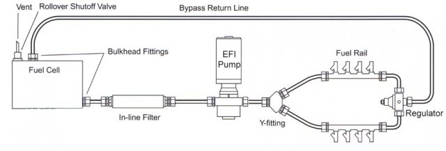

I don't have words to describe how I'm feeling right now. I just started up the LS1 for the first time... VinhZXT, you are a genius. I just came home to work on the z and switch the regulator around to after the fuel rail. Started it up, and... it worked! Thanks for all the help and response guys, I really appreciate it. I should have posted my problem a long time ago, but I'm just glad to have it working now. Thanks everyone. John -

oh man! I can't believe I had it set up wrong. I could have sworn I thought the regulator and gauge went before the fuel rail. Wow, I totally had this one wrong. I really hope this fixes the problem... thanks man. here is the picture i looked at to realize what you were talking about. Should I really put the schrader valve back on or is that just to keep the fuel from leaking out if you disconnect the line? -

Alright, this is an older picture, but the fuel pressure regulator and gauge are just before the fuel rail inlet now. -

VinhZXT, I was refering to the schrader valve on the end of the fuel rail, on the fuel return end. I took it out because I was using an -AN connection. The fuel pressure regulator I am using is an Aeromotive with a fuel pressure gauge just before the fuel rails. It is set at 58-60 and remains there while it fires. -

Ok, after countless hours in the garage trying to brainstorm and come up with the possible reasons my car is not starting, I have run out of ideas. I put in a rebuilt LS1 last summer and never got it to start up. Here is the problem: When cranking, the engine will crank without firing for the first couple cranks. Then, it will start to fire in each cylinder, one every couple strokes. Once I have been cranking it for a little while, there is firing in all of the cylinders, but its very rough and it wants to die out. The longest I can get it to stay running is only about 2-3 seconds, then it will cut out. It will also not start at all when I just touch the gas, as if more air is making it cut out completely. Right when I start it, it will fire a cylinder and a few others with no problem, after that it will just die out slowly. I have a custom harness and re-flashed computer from Speartech, but before I got the harness, I had the stock harness and un-flashed computer and it was doing the same thing. I know my harness and computer are good. I checked compression on all cylinders and it all checked out ok. I checked my grounds, all the sensors are plugged in, I checked plugs and plug wires, all looked good. When I checked the plugs, they were somewhat dark and a little wet. I am sure all my wiring is good, cause I get spark on all cylinders, and all my injectors pulse. Each cylinder does fire and gets good spark. I also checked to see if it was reading any codes, and no problem codes came up. I am out of ideas and am getting depressed because so much time has gone in, and its still not working. Please, if anyone can help pinpoint this problem it would make my year. this has been the one thing that has kept this car from being on the road. Please, let me know what your thoughts are and if you have any suggestions. Thanks, John
