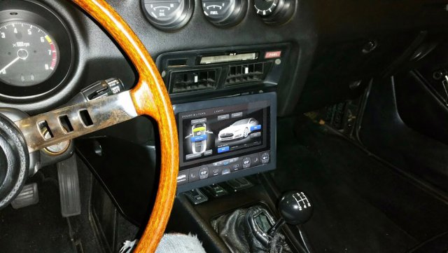

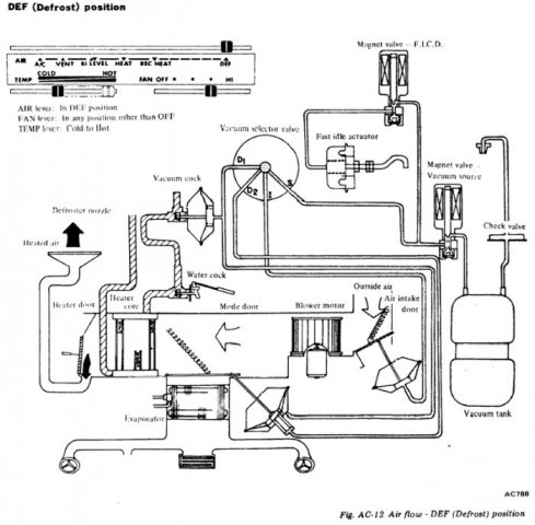

  4. Oh man, the leaves....so many leaves. Working on this has kinda given me a bug to do something drastic. I'm looking at all these vacuum actuators and wondering what it might take to remove the entire vacuum system from the HVAC and replace it with an Arduino digital controlled system. Here is a mockup I did using the Tesla interface on an extra tablet I have laying around. I think I have the skills/friends to make this work, but I'm not sure if this might be a bit....much? I'm studying up on the FSM right now trying to figure out the different actuator and water cock positions for different settings. What do you guys think?

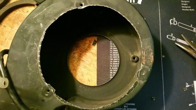

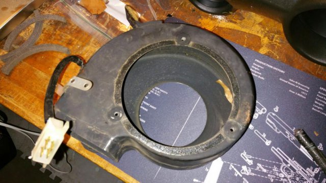

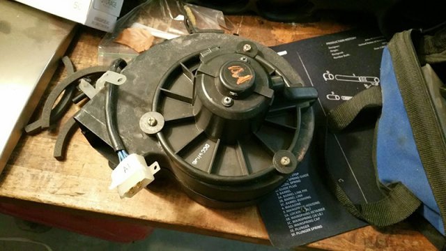

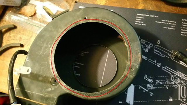

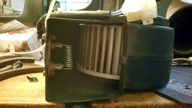

  5. I spent several days researching ways to improve the air output on my 76 280z and wasn't able to find a really nice walk through, so I thought I'd share what I did. It looks like most of the people who put 1988-1991 Honda Civic blowers in their Z weren't able to feel a big difference. I noticed some people also suggesting using 1993-2004 Kia Sportage blowers. So, off to my junk yard I went. I found both a Civic and Sportage blower. After comparing the two, the Kia blower seemed better built and had a larger cage so I bought it for $30 and proceeded to my Z. The nice thing about this upgrade is that the Kia blower is roughly the same size, it rotates the correct way, it uses the same wire harness, and it uses the same mounting holes. It just so happens that I have taken my dash out to install a dash cap and add LED instrument lights. I don't know if you could do this upgrade with the dash in place because the entire blower housing has to be removed. This is the guide I followed for removing my dash (PITA!) http://www.classiczcars.com/topic/5934-removing-dash-and-interior-for-paint/ Here is the blower housing location The original blower and cage are on the left. The Kia unit is on the right I removed the foam padding from the fan housing since the kia unit doesn't need the extra spacing. Next, I placed the Kia blower cage over the hole, lining up the bolt holes, and marked the area to widen. I highlighted this in red. Using some aviation snips, I cut out the excess metal. I cleaned up the hole with my Dremel later. I then placed the new Kia unit in the blower housing and secured it using the original bolts and washers. The unit spins free and has just enough clearance The original Z wire harness fits right into the new motor. I plugged it in to make sure it works and it really seems to put out some air. I'll post another update once I get the dash back in.
