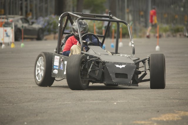

  1. Here is another pic with the high speed nose attached rather than the motorkhana nose.

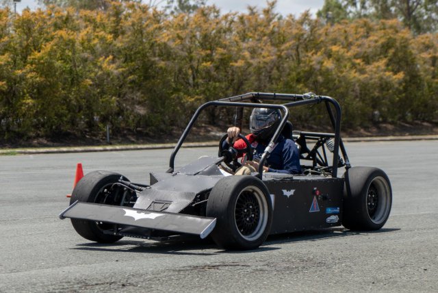

  2. Hi, Sorry for not posting more regularly. I have since retired the chassis described in my earlier posts and replaced it with a rear wheel drive mid mounted chassis. The old chassis was losing much of the advantage through wheel spin. The new chassis launches sooooooo much better. But it has made front end grip a bigger issue.

  4. Hi again, The last event didn't go to plan. I had a major suspension failure. Basically it was a design flaw. I hadn't anticipated the vertical force resulting from the twisting motion of the lower control arm within it's mount. The result from 18 months of competition was the mount was flexing and eventually gave way. I have replaced the mounts and reinforced them so they can nolonger flex. I am all ready for the event this Sunday. This is a khanacross which I have been waiting months for. Khanacross is perfect for this car so I am aiming for great results. If anyone local is interested it will be held at the back of the Willowbank drag strip. Spectators are free. Competitors are also welcome and are $45 per entry assuming you have a CAMS license and a Rally extension from your CTP provider if you have a road registered car.
  5. I have replaced the clutch and reconstructed the car. I have also reduced the front camber by 1 degree (from neg 3 to neg 2 degrees). I was surprised by the extra resistance I feel when steering. I am really looking forward to giving this a go on Sunday.
  6. It turns out I only missed 2nd place on Sunday by 0.27 seconds. I have also now had the chance to pull the car apart to investigate the vibration. There were two problems. One probably caused the other but I am not sure which is which. Two of the springs popped out of the clutch plate. The retainer bolt that secures the Flywheel and adaptor to the motor output shaft snapped. Either of these propblems could have either caused the vibration or resulted from the vibration. I suspect the retainer bolt as it was way too easy to remove the remaining portion of bolt, indicating it worked it way loose. The good news is that I should have it all fixed over this weekend in time to compete at the next event next weekend and beat some Porsches and Clubmans.

  15. Hey guys, It has been a while since I posted on this forum. I still own and love my Zs. But I have been distracted on other projects. I have built the first electric motorkhana / khanacross car in Australia. It has been competing for 12 months now and is just starting to realise it's full potential. The chassis is home made from the ground up. most of the mechanicals are mostly from a Nissan Pulsar (small front wheel drive hatch). The car is front wheel drive because they have a slight advantage over rear wheel drive in this form of motorsport. The motor is an Advanced DC 9 inch. This type of motor is usually used for converting a 1200KG road car. So in my 500kg car it goes quite nicely. The controller is a Zeva 1000amp unit (although so far I have only tested it to 800amps) So far the peak power I have seen has been 67KW. But its the torque that is the real advantage of these motors with around 440nm from 0 revs. The batteries are 170v lithium Ion from a Chevy Volt. The total capacity is 7KWH and it lasts a full day of racing for me. I'll post some pics and videos in a minute.
