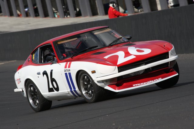

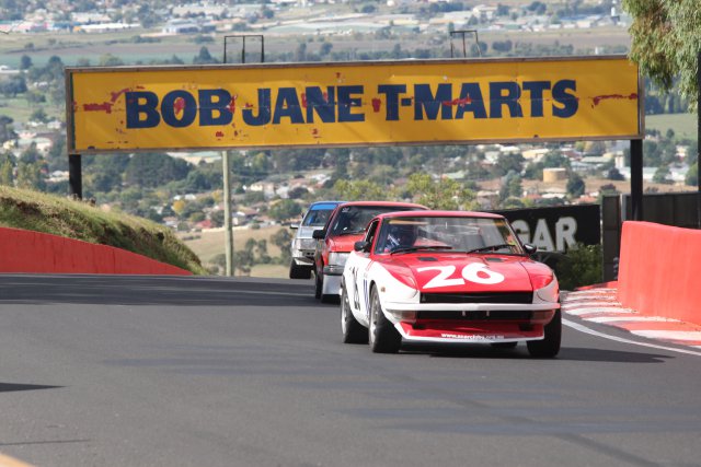

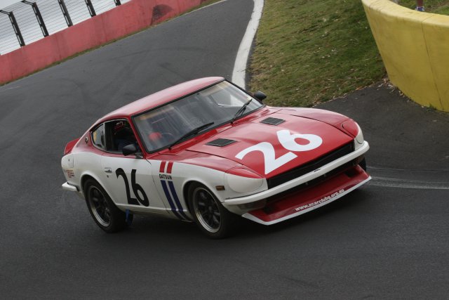

Here is my road registered race 140z plus my original 280zx that started my obsession 20 years ago. The Race car pics are at Mt Panorama Bathurst, arguably one of the best tracks in the world. Kara.bmp
