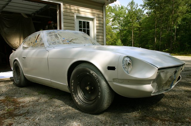

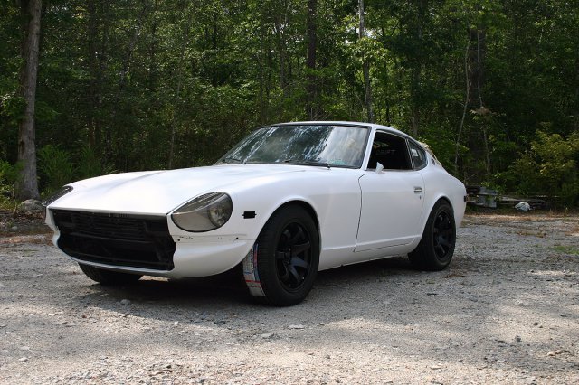

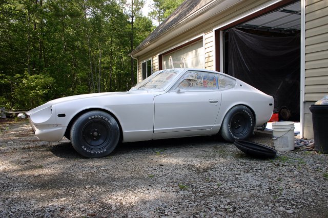

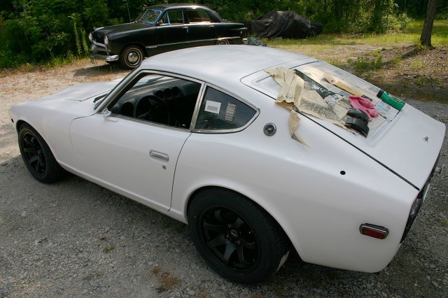

Correct- I'm just using the same gloss white in a spray can for the jambs, hard to reach areas, spots I missed, etc. I used a cheap spray gun and it came out okay...not the greatest but I've almost finished the wetsand/compound/buff process and it definitely makes it better. Sprayed with a 4-1 paint to acetone mix. I'll get some close-ups once I get the compounds worked in...thanks!
Thanks guys- No real rubbing in the rear as of yet...I honestly have not driven it much though, so I can't say 100% but yeah it is going to be close. Clearance to the strut towers is VERY close, but doable. I may try to roll the rears if it becomes an issue...at least do that before biting the bullet on flares or not. Not spray bombed...although it kind of looks that way in spots. Don't think my gun was dialed in very well, but I have just finished the first/second wet sanding, and first buffing w/rubbing compound and it definitely smooths things out and gives it a decent gloss.
I appreciate it- they are xxr 522's, 16x8, 225/50's all around
Doing the low-buck Rustoleum treatment here...still have to buff and polish but you get the idea. Better than before though, that's what I keep telling myself!
Thanks for the kind words- the rims are 16x8 all around, 225/50 tires. Yeah it's lowered a "tad", pretty close in the rear as of now, I planned on using a set of flares, but for the moment I'm going to try and roll the lips just a touch to help out some. I did have to tweak the inside/lower lips of the front fenders, as they just barely kissed the tire at full steering lock.

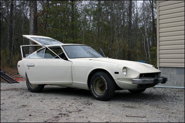

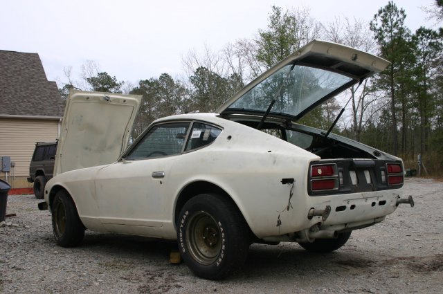

Hello all- I finally picked up a 280 I scored on Craigslist a few months back. It had been sitting in a garage for roughly the past 9 years or so, but thankfully it had been kept up fairly well, and it already had a swapped 280zx motor/tranny installed. Just wanted to share some pics of the progress so far, I've got about 4 too many projects going on but this one is the closest to being drivable at the moment. Off of the trailer: Rusto' paint!: New XXR wheels, tires, fairings, still have detail stuff like trim and some interior items left:
