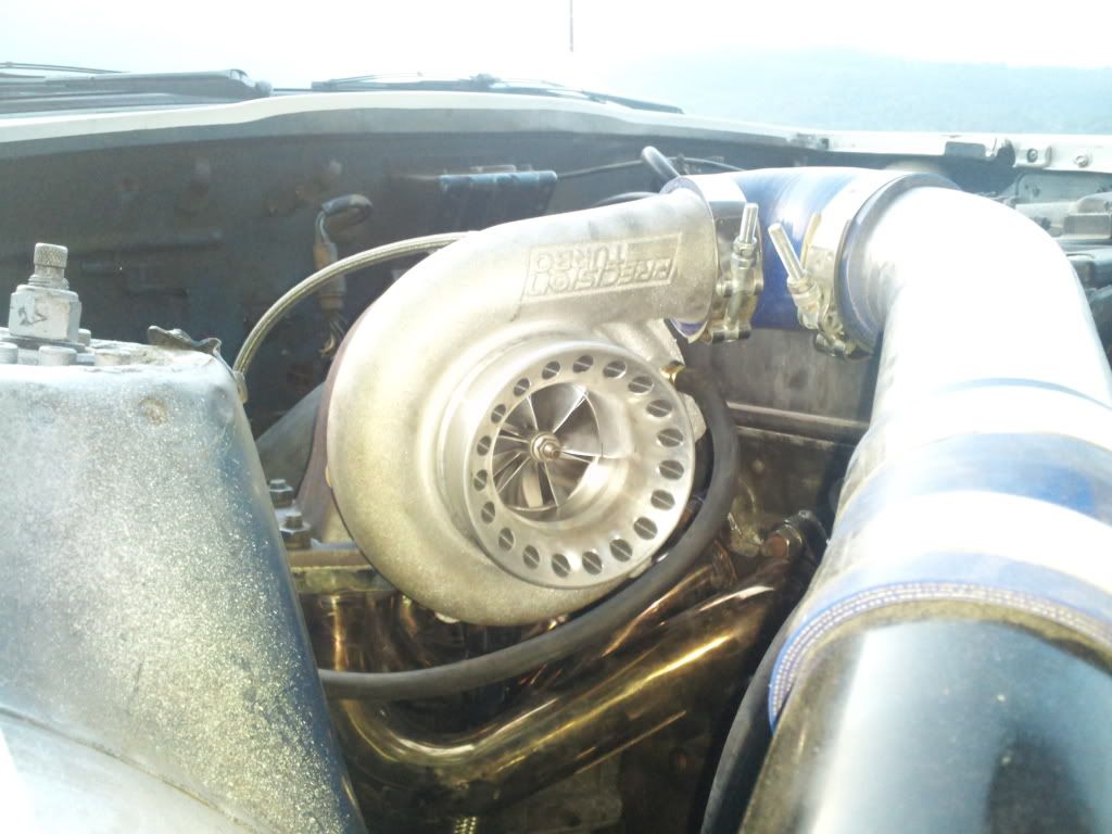

I dropped my datsun 1200 project, and i have a 6262 for my 240z l24 engine, this turbo will fit on the L24 engine?, and another inconvenient is the external wastegate, i have to put on my stock turbo manifold.
i am thinking about oside tiger injectors, because i bought venom injectors and are miss matched, does not work.
Some body knows another injectors options?
all suggestions are welcome :D thanks!

You can buy rc 550 injectors from ebay: http://shop.ebay.com/i.html?_nkw=rc+550+injectors+6&_sacat=0&_odkw=rc+550+injectors&_osacat=0&_trksid=p3286.c0.m270.l1313
Get a fuel rail for the injectors also.
That turbo will fit, you can then weld on an external wastegate to either an adapter or drill a hole into the stock exhaust mani and weld a pipe like noodle (forum member)

I think you will really like the 6262 on the L24, i have one with a .68 ex housing on my 1jz and it spools
on my vg30 datsun 1200, spools around 4k too but when spools spools i lost traction on 3 and 4 gear, and i have to depress the gas pedal.
Yes it has antisurge!
