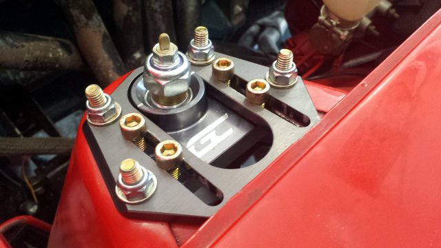

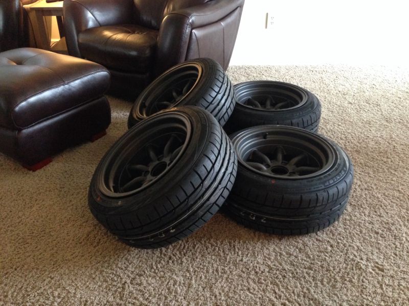

Ham8urger Posted June 25, 2014 Share Posted June 25, 2014 Well I ended up getting Sakura Garage coilovers with their bolt in camber plates... Should arrive any day now. http://sakuragarage.com/products/datsun-suspension/ And I actually decided against the Shakotans and got the Rota RKR's. 15x9 0 offset with 205/50/15's Dunlop Direzza DZ102's Quote Link to comment Share on other sites More sharing options...

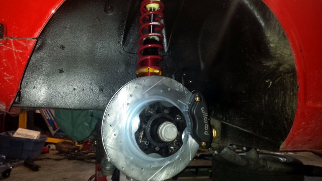

Orangetang Posted June 25, 2014 Share Posted June 25, 2014 (edited) Ran into a bit of a conumdrum test fitting my 15x9-0mm Shakotans on my Z the other night... Installed GC coilovers with a 2.5" OD spring, 4 piston Wilwoods and AZcar a-arms and knuckles... Rim doesn't clear the tie rod end, not even close. I'm out in the field right now, but when I get back I'll do the other 3 corners, see if the rears clear the brakes (same front and rear) and go from there. Maybe I'll need to revert back to straight knuckles or run a large spacer...? With the 15x9-0mm it looks like I can get away with a fairly wide spacer and still stay under the fender lip with some camber. I'll post more pics, and info regarding these rims and Wilwood calipers / bump spacer clearance as I find out a solution. If the rod end wasn't in the way, it's questionable that these would clear the calipers anyway. Edited June 26, 2014 by Orangetang Quote Link to comment Share on other sites More sharing options...

ol doc gully Posted July 7, 2014 Share Posted July 7, 2014 Awesome, looking forward to seeing those on your car - been very surprised more people don't buy the RKRs. Well I ended up getting Sakura Garage coilovers with their bolt in camber plates... Should arrive any day now.http://sakuragarage.com/products/datsun-suspension/And I actually decided against the Shakotans and got the Rota RKR's. 15x9 0 offset with 205/50/15's Dunlop Direzza DZ102's Quote Link to comment Share on other sites More sharing options...
Ham8urger Posted July 11, 2014 Share Posted July 11, 2014 I will post pics Quote Link to comment Share on other sites More sharing options...

Orangetang Posted July 16, 2014 Share Posted July 16, 2014 Looks like 1 1/8" spacer would be the minimum to clear a tie rod end mounted to AZC knuckles. I'm tempted to order a set of 4x114.3mm wheel adapters just to see how it sits, but I'm thinking it'll look pretty stupid. This is with a 0 offset 15x9 shakotan. To clear Wilwood discs, I think 1/4" would be fine, so the other option is to lose the knuckles and see if the stock ones fit, or drill out the AZC knuckles a bit so the rod end ball joint sits higher. This 15" rim isn't a great fit for aftermarket brakes or for use with LCA drop spacers, it appears. Quote Link to comment Share on other sites More sharing options...

Orangetang Posted July 21, 2014 Share Posted July 21, 2014 Well, if you already know that 15s probably will not clear your lowered tie rod ends, you should plan on going with a narrower rim to account for the spacers or offset you'll need. I'm playing guinea pig again, waiting on 1" adapters and 1/4" spacers to arrive for a test fit to see what is really needed. The issue is, you might end up running >1" of spacing, and require flares. It's possible the T3 bump steer spacers would work since they're not as tall, but they're also going to be bolted to longer knuckles, so they might REALLY not fit. The good news is, you can just remove them if they don't fit until you figure out a rim fitment. With my zero offset rim, the front and rear wilwood calipers hit the inside of the wheel. A zero offset wheel will not clear them. When you pull everything apart and do your wheel bearings, you might aswell install some new longer studs. I wouldn't bother with the nismo 50mm ones though. That's a little overkill for what you'll be running. S14 studs should be PLENTY long. Quote Link to comment Share on other sites More sharing options...

Orangetang Posted August 3, 2014 Share Posted August 3, 2014 (edited) Not the best of pics, but here are 15x9 -0 on 1" spacers with a little camber. Wider than I'd like... but easier than all other alternatives, assuming I can massage a little room for these things to turn left and right out of the fender, tension rods, and control arms... Felt like the 1/4" spacer would work to clear the wilwood calipers, but the tie-rod issue isn't going away so easily. As is, the brakes are still a tight fit, and the tie-rod is about 3/16" from the rim lip... Edited August 3, 2014 by Orangetang Quote Link to comment Share on other sites More sharing options...
