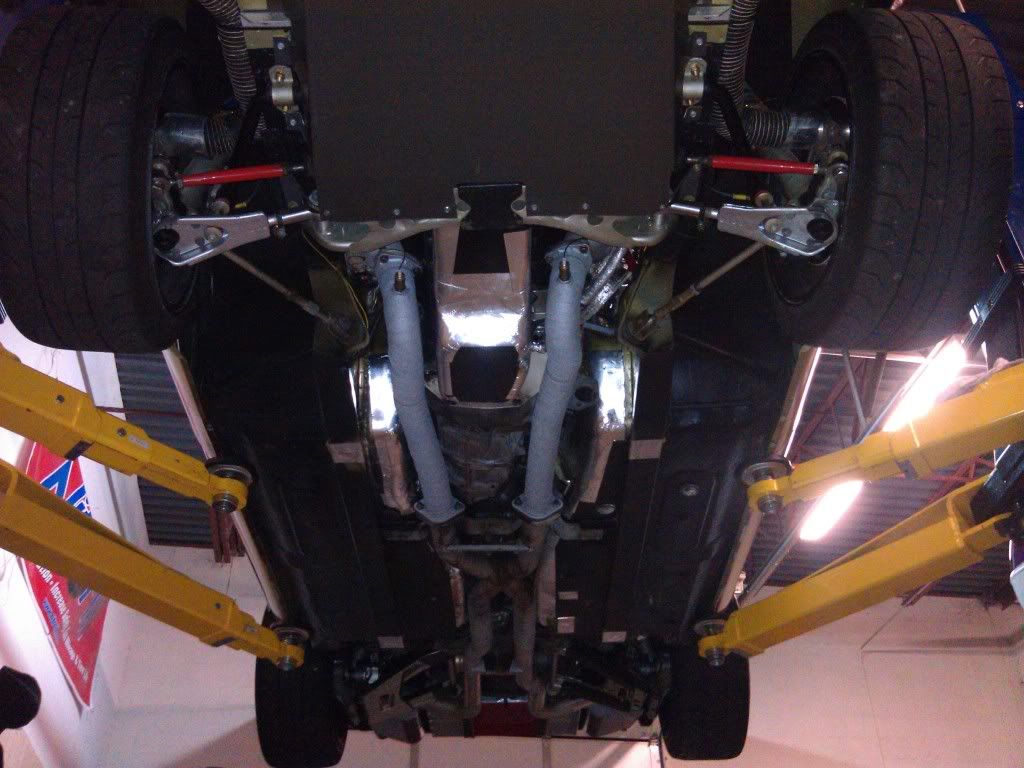

bjhines Posted November 29, 2011 Author Share Posted November 29, 2011 Well... The track event had it's ups and downs. The upside is that oil pressure is a steady 55psi(Warm) at speed and the temps climb slowly to ~200 and pretty much stop climbing for 6 laps or so. Yaaayyyyyyy!!!!!!!!!!!!! The DOWNER is a bad leak at the front of the pan that would lead to oil buildup under the car/exhaust and smoking after braking zones. My hypothesis is: The oil pan gasket needs a THICK front seal which apparently is NOT what I have with the blue silicone gasket I purchased. It is so hard to tell what the heck to use.. The seal is indeed "thick", but I think it is due to the extra thickness of the side rails and ends up loose in front with the pan bolted on. Does anyone know what years the Chevy engines changed from Thick to Thin front sections???, and is the Eldlebrock 2 piece timing cover a "thick or thin" lower section??? What a pain in the butt... but I am making brutally slow progress. I still had fun at the event considering my student had a E63 AMG supersedan. Good freaking lord... what a car! Yeeeeeeee... Haaawwwwwww... all that Lux and weight and is still accelerates like my HybridZ Race car. $$$$$$ you can get something functional and entertaining for 6 figures. Quote Link to comment Share on other sites More sharing options...

bjhines Posted December 1, 2011 Author Share Posted December 1, 2011 Needless to say, my undercarriage is well oiled. I am really tired of washing oil off the back of my new car. I put an emissions smoke leak detector in the oil dipstick tube and turned up the flow enough to pressurize the crankcase. The front seal is TOO THICK. The front corners of the oil pan are not mating to the block. Also... The distributor adjustable collar leaks profusely at the split in the split collar. I will seal that as well. Quote Link to comment Share on other sites More sharing options...
