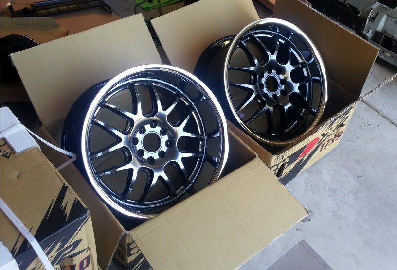

I've always really wanted 15's for my car... but I really like these and I keep worrying about whether or not the 15's I want will clear the brakes I want. I am planning on doing ZG flares though and I don't particularly want to run a huge spacer. In the picture you posted, do you have any spacers on? It looks like that would work great with a 1 inch spacer and ZG's. That is assuming there is no spacer there... I think anything over a 1.5" spacer is a little sketch... but I could just be naive. Anyways these are the coolest 17's I've seen that aren't a ridiculous price. I may end up going for these too, depending on how much spacer they need.

I haven't ordered spacers yet, so in the pictures they are just mocked up against the studs. You might be able to get away with a 1.25" in the rear and 1.5" up front if you're running coilovers. That would give around 5.1" and 4.9" backspacing respectively.
