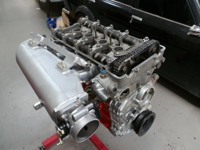

PMC raceengines Posted March 1, 2012 Share Posted March 1, 2012 (edited) Well im putting the FJ20 back in the zed, but i need to make some parts so though id put some pics up and show the fj20 off. Not to many in the US but there a great motor and i love them this one will make 600hp engine and will run E85 ,i will post pics as i build new parts hope you like the build. first post the new dry sump just finished it, i will have it all cleand up and painted tomorrow Edited March 1, 2012 by PMC raceengines Quote Link to comment Share on other sites More sharing options...

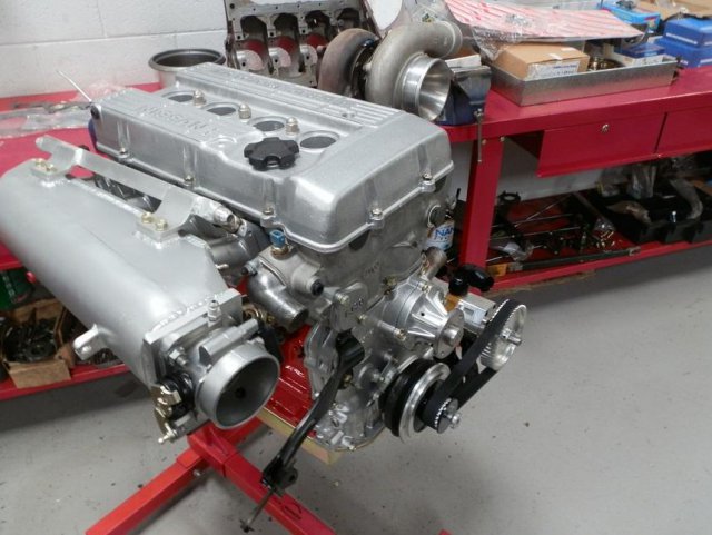

PMC raceengines Posted March 2, 2012 Author Share Posted March 2, 2012 More pics of todays work , made the oil pump bracket and started on the inlet manifold , Quote Link to comment Share on other sites More sharing options...

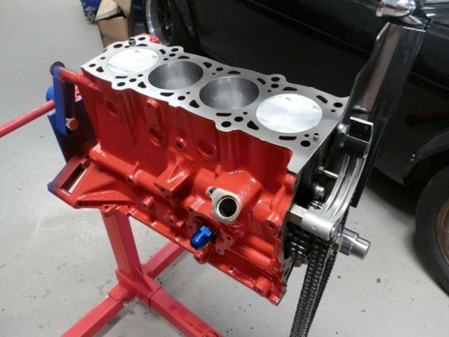

PMC raceengines Posted June 12, 2012 Author Share Posted June 12, 2012 Well just finished the crank. It needed lots of work as i found a crack in it, so i welded it up and spent some time making it race ready come up a treat , also found a crack in the head ... So i replaced it and ported it the same as the old head as it had made great hp before , there is a lot of work to go but its getting there Quote Link to comment Share on other sites More sharing options...

PMC raceengines Posted July 11, 2012 Author Share Posted July 11, 2012 made the oil lines tonight getting close now Quote Link to comment Share on other sites More sharing options...

Xnke Posted September 13, 2012 Share Posted September 13, 2012 (edited) Peter, you said you welded a crack in a race crank...that doesn't seem like good practice to me. If I was going to be pushing an engine to the limits, the crank is the one place I'd cull hardest on. I know that proper procedure can yield a strong product, but knowing that there is a welded up crack in the crankshaft at 10,000RPM would just give me the heebie-jeebies, ya know? Are FJ cranks THAT hard to get? And by the way...that oil pan is just gorgeous after the plating. We'll have to hear this thing run when it's done! Edited September 13, 2012 by Xnke Quote Link to comment Share on other sites More sharing options...
PMC raceengines Posted September 14, 2012 Author Share Posted September 14, 2012 Yep i hear you , but just about every crank is cracked in the same spot , i have fixed about 5 of them so far and all have lived long hard life in race cars , so i think it will be fine Quote Link to comment Share on other sites More sharing options...
