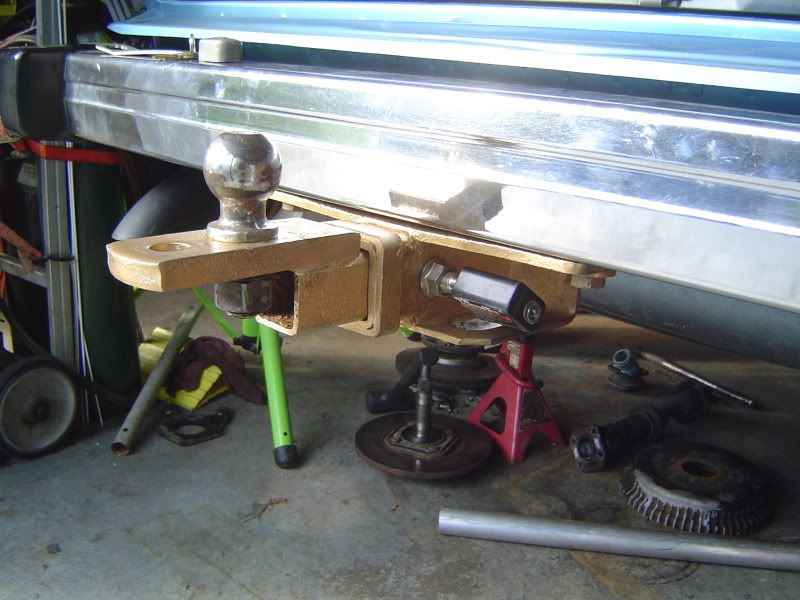

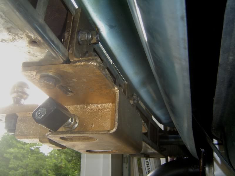

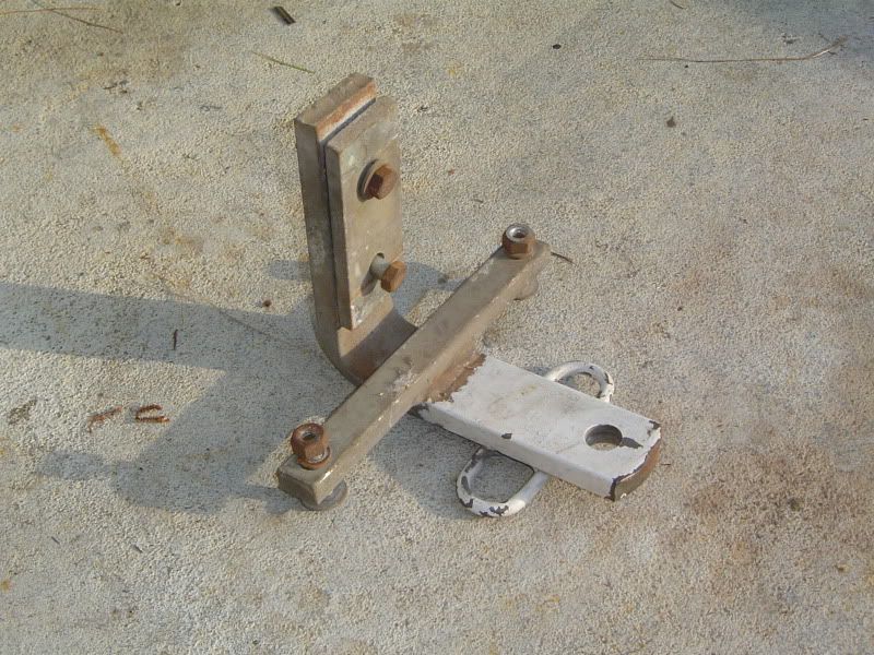

yellowoctupus Posted May 13, 2012 Author Share Posted May 13, 2012 Here's your non fixed hitch: I'm still not sure if I need to have a stabilizer bar going into the spare tire well or the rear diff mount or something. I can put my weight on my receiver and it seems pretty sturdy, but you can feel the smallest bit of flex at the bumper mounts. Mounting to the wheelwell puts some goofy bends in the bracket, (giving it a prime place to bend/ flex), and so does going to the rear diff mount. (besides the fact that is has to be super long to make it under the gas tank, etc) It does look like the purely 'pulling' load is almost directly centered on the bumper (ie, no flex if there's no moment). I also drilled a closer hole in the hitch to reduce the moment from the tongue weight. This came off my 1980 Mustang, it only mounted to the bumper. I used this model for my reciever hitch setup. I'm still not sure if I need to have a stabilizer bar going into the spare tire well or the rear diff mount or something. I can put my weight on my receiver and it seems pretty sturdy, but you can feel the smallest bit of flex at the bumper mounts. Mounting to the wheelwell puts some goofy bends in the bracket, (giving it a prime place to bend/ flex), and so does going to the rear diff mount. (besides the fact that is has to be super long to make it under the gas tank, etc) It does look like the purely 'pulling' load is almost directly centered on the bumper (ie, no flex if there's no moment). I also drilled a closer hole in the hitch to reduce the moment from the tongue weight. Quote Link to comment Share on other sites More sharing options...
