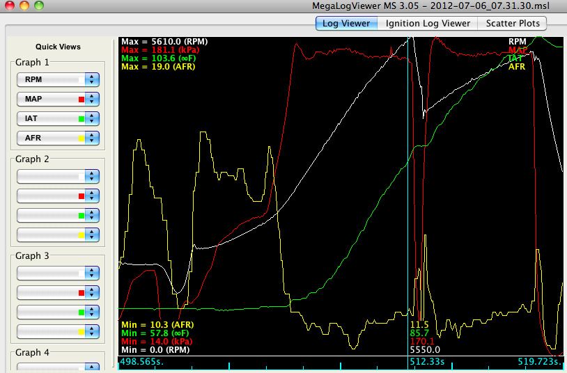

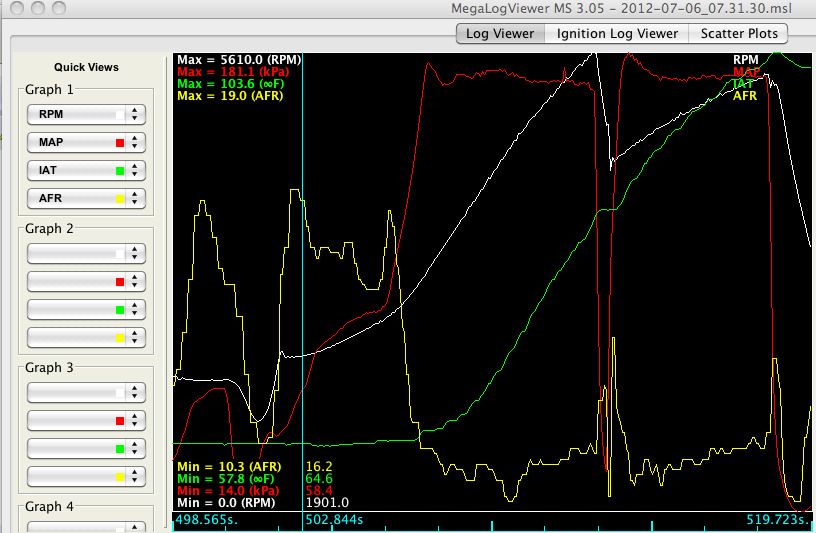

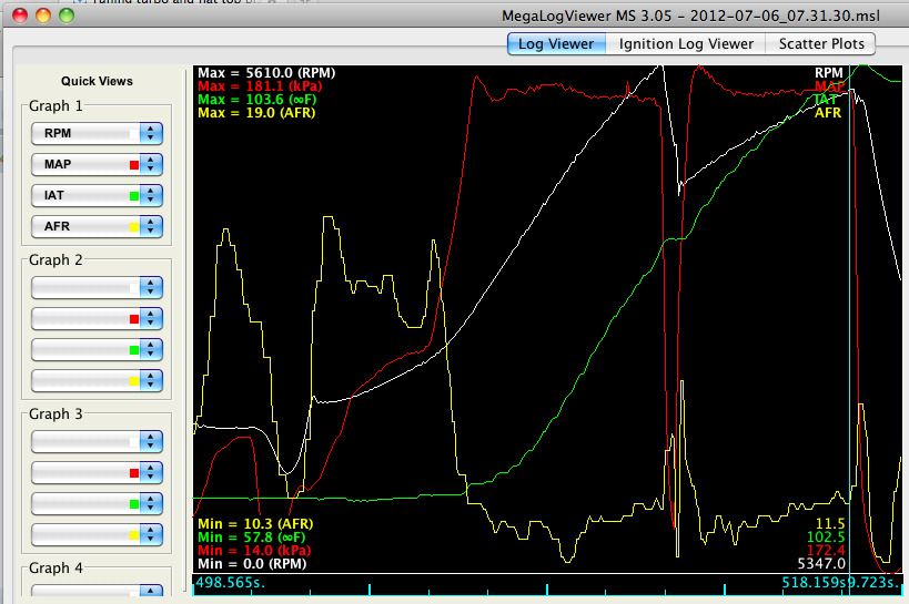

Datsun Deron Posted July 7, 2012 Author Share Posted July 7, 2012 (edited) Well I managed to get out and do some data logging yesterday morning and had some interesting results. I'll have to retract my previous statement about this being an FYI post as I've now got technical questions... I did a 3rd and 4th gear pull to around the 5300-5500 mark. -The lowest IAT that MS saw during the drive was 58 which is consistent with the weather network. -At the beginning of the pull @1800 rpm my IAT's were 64.5 (first screen shot) -At the end of the 3rd gear pull my IATS were at 87 degrees (second screen shot) -From here on out the IATS just keep climbing and climbing -At the end of my 4th gear pull my IATS were at 102 (last screen shot) -I wasn't able to get into 5th since the speeds were getting up there. I was very surprised to see the IAT's continue to climb until I let off the throttle. In my mind I thought it would level off somewhere but there was no sign of that. I'm just wondering if the readings from this sensor are actually accurate. The sensor has a potential of getting heat soaked from external sources, radiator etc. That being said I can't see it getting heat soaked that fast when the car is moving I've just seen heat soaking at idle. My turbo has a heat blanket and my manifold is wrapped as well. The only potential candidate I could see would be the radiator. Also when I let off the throttle between gear changes the IAT temps did level off. So that must be an indication that it is accurate? Have others seen similar results where the IATs continue to climb on runs with multiple gear changes? As far as I can tell there are two major issues that need to be addressed. The air filter is pulling in hot air behind the radiator. (im not running a shroud anymore like the picture below since I'm running a pusher style fan now). And the poor placement of the intercooler with no ducting. I also need to change the bins in my timing and VE table as im getting into the 180s for MAP at times. The picture below shows where my IAT sensor is (it's on the bottom of the pipe) right before the throttle body. It looks like I've got some changes to make and more data logging to do. Edited July 7, 2012 by Datsun Deron Quote Link to comment Share on other sites More sharing options...
letitsnow Posted July 7, 2012 Share Posted July 7, 2012 (edited) The temperature continuing to rise is completely normal. Intercoolers are in effect a thermal reservoir, the cooling capacity of the atmospheric air flowing through them isn't on the same level as the heating capability of the turbo. There is more heat going in(turbo) than coming out(atmosphere), so the aluminum heats up, raising the intake temp. Air DOES still cool the IC while on boost, just not anywhere near as much as the turbo heats it. This will hit a steady state at some point, but it is higher than what we want. After you get off the throttle and the turbo is no longer heating the air, then it's relatively easy for the atmospheric air to cool the IC down to ambient. The vertical flow IC's are great for engine airflow, but they sacrifice some cooling capability. My car, on the dyno(not anywhere near the airflow of going down the road), MAT started at 75F and ended at 110F. I see much less of a rise while actually driving. Edited July 7, 2012 by letitsnow Quote Link to comment Share on other sites More sharing options...

letitsnow Posted July 7, 2012 Share Posted July 7, 2012 (edited) Do you have a real big IC? You also have a bigger(more efficient) turbo IIRC. From previous logs, the t3 at ~10psi is putting out 200-240* temps pre intercooler, mine at 17-19(falls off hard after peak tq) is probably over 300. All IC's will do this to an extent, but if you can shed heat as fast as you put it in(huge IC and efficient turbo/lower boost/meth), the IC temp won't change. Heat in vs heat out is the key thing here. Edited July 7, 2012 by letitsnow Quote Link to comment Share on other sites More sharing options...
