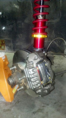

duragg Posted January 4, 2013 Author Share Posted January 4, 2013 (edited) Mocking up the POS ZG Flares, they just wouldn't sit any higher. I did all I could for now. I am going to make my own flares anyways, AMG DTC touring car style. Its not the end of the world if I have to cut more and re-weld. But I needed to get the coilovers installed and on the ground to make some progress and clear space in the shop. Front is all done. Just need to fab one last Brake line to connect to the flex-line. Not quite sure how I want the alignment of the tube and hose (I messed up and deleted the tube fitting on the strut for the brake line standoff). Rear is mostly done. Need to fit the P/B cable and finalize the new Steel lines. Brake lines are fun. I forgot how much I enjoy making custom lines. Needs: * Assistant... * To show up... * Bench bleed M/C * New steel lines from switch to the old deleted BPV with unions. * Hack front right fender for tire clearance to at least get driving. * Once driving with the final ride height I can tweak any last fender issues and make some trick custom flareZ. Ciao. Edited January 4, 2013 by duragg Quote Link to comment Share on other sites More sharing options...

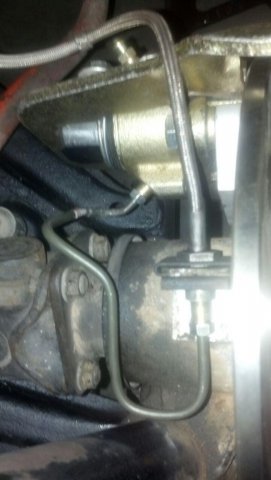

duragg Posted January 5, 2013 Author Share Posted January 5, 2013 (edited) Posting from yesterday pics. 280Zx rears. And a new brake line. This was a 12" piece from Orielly. I didn't like the NAPA brand tube at all. Lots of clearance around the spinny parts. Edited January 5, 2013 by duragg Quote Link to comment Share on other sites More sharing options...

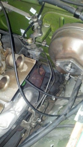

duragg Posted January 5, 2013 Author Share Posted January 5, 2013 (edited) Posting from yesterday pics. Deletion of Brake Proportion valve. Just made new lines and connected all straight for now Edited January 5, 2013 by duragg Quote Link to comment Share on other sites More sharing options...

duragg Posted January 10, 2013 Author Share Posted January 10, 2013 Sure is nice to drive hard and not bottom out the front springs. Quite a different car with the Coilovers. I haven't tweaked the ride down to the final height yet, and the front Toyota S12w calipers aren't nearly bedded in fully yet. They still aren't making full contact with the rotor, so have a ways to go. Not sure a booster is needed with those. Quote Link to comment Share on other sites More sharing options...

m1ghtymaxXx Posted January 14, 2013 Share Posted January 14, 2013 Nice work! What year 280zx calipers are you using? Quote Link to comment Share on other sites More sharing options...

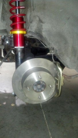

duragg Posted January 15, 2013 Author Share Posted January 15, 2013 I don't know the exact year as they came to me in a bucket with brackets for $50 bucks. I recall the rebuild kits were 1981? They are the GIANT ones that look like pie tins with a vice in the middle. Quote Link to comment Share on other sites More sharing options...
JMortensen Posted January 15, 2013 Share Posted January 15, 2013 (edited) 79-81 are the big huge ones with the opposed double piston design. the 82-83 look like a normal caliper. Edited January 15, 2013 by JMortensen Quote Link to comment Share on other sites More sharing options...
duragg Posted January 16, 2013 Author Share Posted January 16, 2013 We are talking about the rear 280ZX anchors? THey have an unmistakable... looks like a large flour tortilla, fried for a salad, draped over a beer keg, with a leg-of-loin hanging out the bottom. I have a picture of the caliper body somewhere, but it is so big, I have to Quote Link to comment Share on other sites More sharing options...
duragg Posted January 16, 2013 Author Share Posted January 16, 2013 (edited) Oh, wait Here it is. Its only one giant piston, with a goofy ratcheting screw inside. Frankly, they fit on real nice and bedded in with the disks nicely. My S12W fronts are still trying to find the whole rotor surface. Took the Tokickos up to #5 front and #3 rear which seems to help the buckboarding. I hit some turns pretty hard under power and wow, quite a setup. You cannot just plow into the middle pedal or all 4 lockup. Ain't no M3, but I think they could absorb a lot of heat. Edited January 16, 2013 by duragg Quote Link to comment Share on other sites More sharing options...
JMortensen Posted January 16, 2013 Share Posted January 16, 2013 Those are the early ZX calipers. There are actually 2 pistons in there. There is one in the traditional place that you screw in to put the pads in, then there is another one on the opposite end of that cylindrical part of the housing. The one pushes the inner pad into the rotor, the other pulls the whole flat plate thingy inwards, forcing the outer pad against the rotor. It's a funky setup and I didn't realize there were two in there either until someone told me. I used that setup with non-vented Toyota front calipers and even with no prop valve I was unable to lock the rears while driving through a puddle at a driver school. It's easier to work on than drums, but it isn't the hot ticket for rear disk conversions IME. Quote Link to comment Share on other sites More sharing options...
