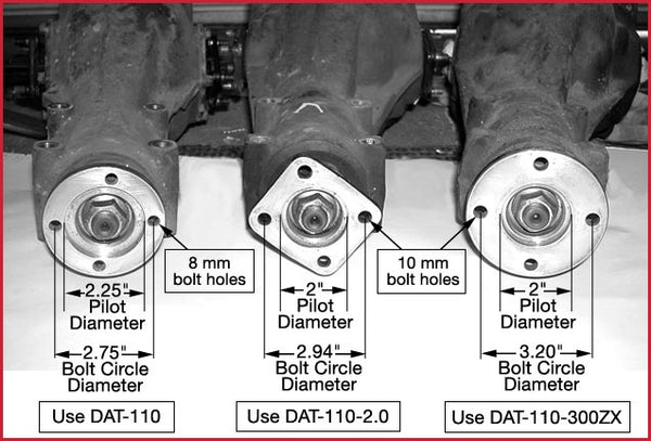

redzedturbo Posted March 31, 2015 Author Share Posted March 31, 2015 I got the differential flange That converts me to run spicer 1310 u joints from jagsthatrun.com The part number for the r200 is DAT-110-2.0 and here is the direct link. http://www.jagsthatrun.com/Pages/Parts_DAT_driveshaft_flange.html Quote Link to comment Share on other sites More sharing options...
