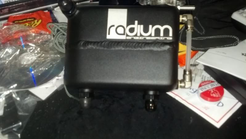

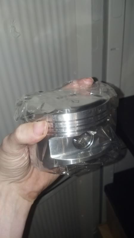

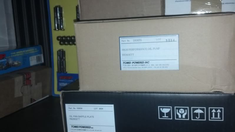

fallenone121 Posted September 16, 2013 Author Share Posted September 16, 2013 Parts Photos...some... Quote Link to comment Share on other sites More sharing options...

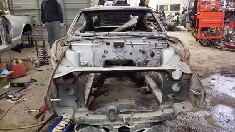

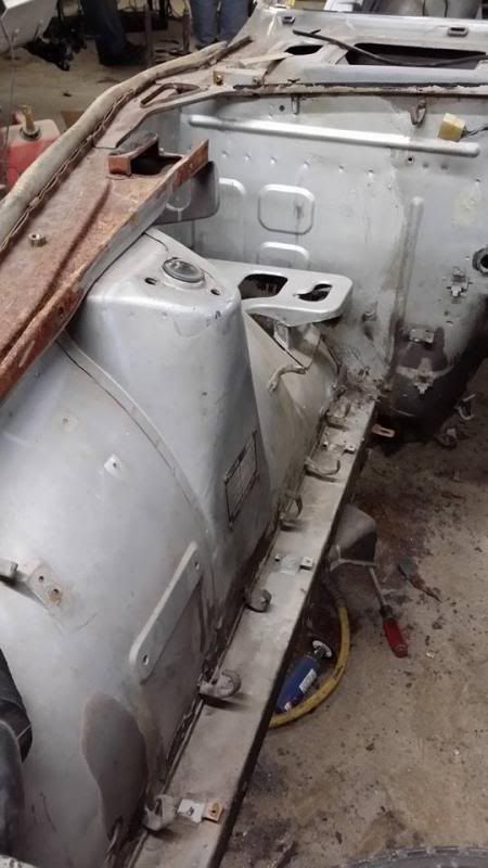

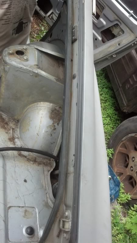

fallenone121 Posted September 16, 2013 Author Share Posted September 16, 2013 Progress photos from the stripdown... Quote Link to comment Share on other sites More sharing options...

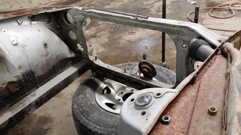

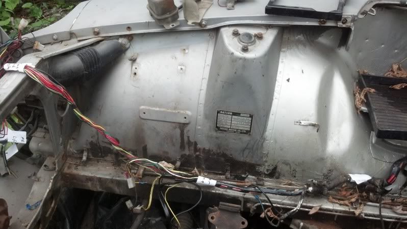

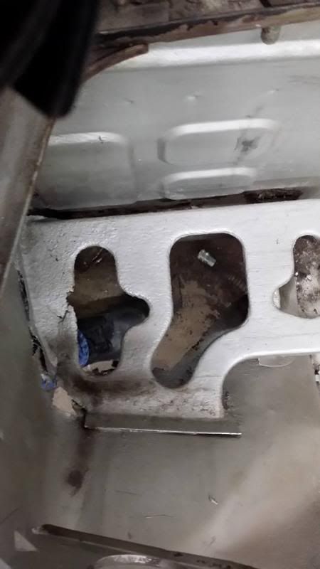

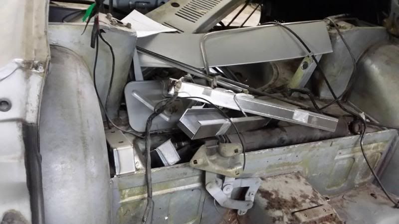

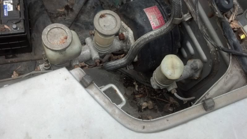

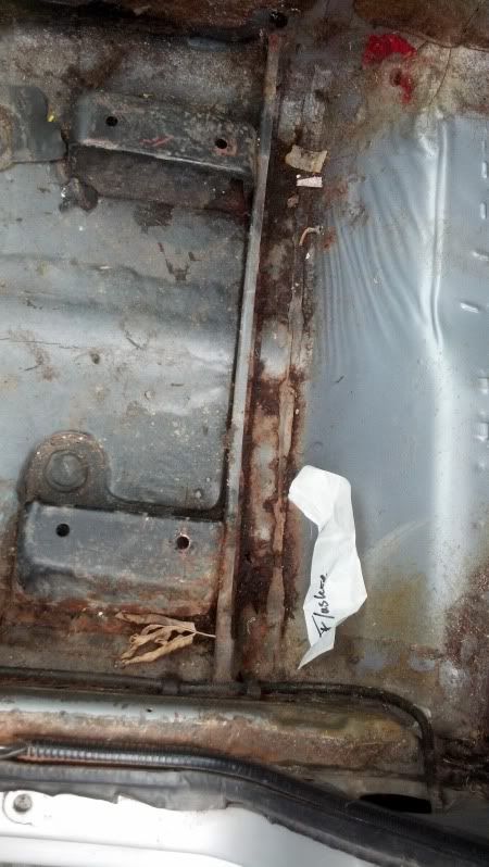

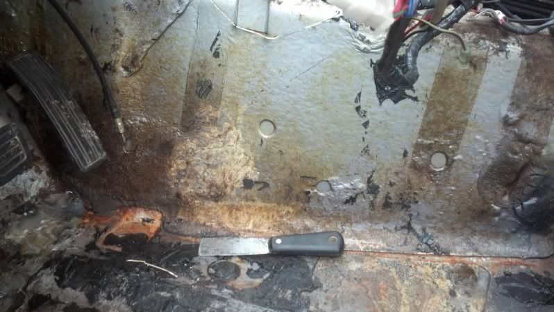

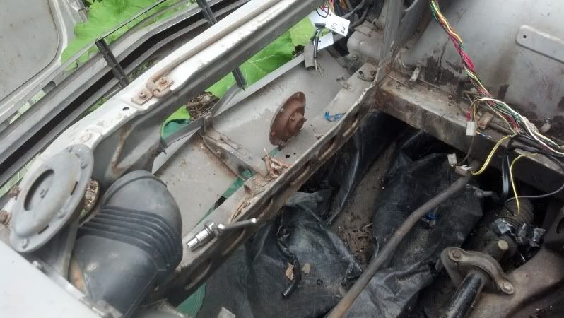

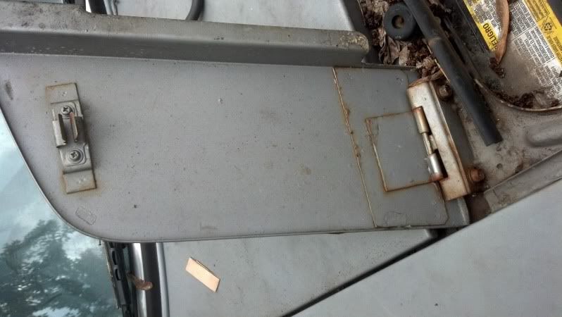

fallenone121 Posted December 22, 2013 Author Share Posted December 22, 2013 Stripdown has been proceeding slowly - much more slowly than I would have otherwise hoped as during the teardown process it was realized that the fenders were rusted nicely and the floors were rusted out with the previous owner having used window screen and ample fiberglass patching to seal up holes in the car that I wouldnt have found if I didnt want to tear it down to make sure everything was structurally sound... And now...for update pics! Quote Link to comment Share on other sites More sharing options...

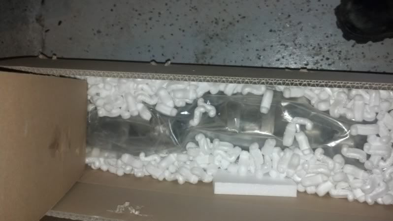

fallenone121 Posted January 2, 2014 Author Share Posted January 2, 2014 (edited) The color I will be going with is from the R35 GTR - Dark Blue Pearl In other news... A box from Zstore arrived! Edited January 2, 2014 by fallenone121 Quote Link to comment Share on other sites More sharing options...

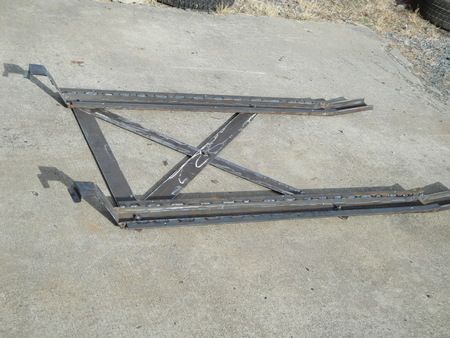

fallenone121 Posted April 19, 2014 Author Share Posted April 19, 2014 April 2014 Update Body and Framework has begun... Quote Link to comment Share on other sites More sharing options...
