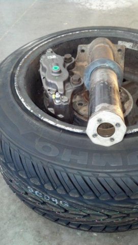

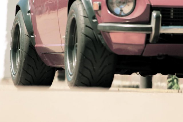

duragg Posted January 8, 2013 Share Posted January 8, 2013 (edited) Rehashing an old thread... 15x10s all around and put 225/50-15 Kuhmos on the front, but they are a tad stretchy for me. Not a great pic but you can see the 220/50-15 on 15*10 Kuhmo Ecsta AST Found this picture of a 235/50-15 on 15*10 are on the back with 15*9 on front. Gives a little more square look in the back and a bit more of the Staggered look I wanted. Is the Toyo Proxes R888 is a Competition DOT tire. But not just a Drag tire is it? I want to go around corners also... The crappy availability of fat-boy-fifteens is malo. Edited January 8, 2013 by duragg Quote Link to comment Share on other sites More sharing options...
